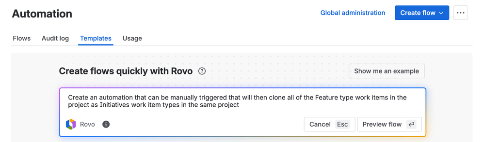

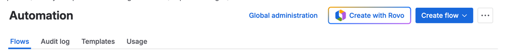

Do you have Rovo available in your environment?
If so you can use the  Create With Rovo button.
You can then enter a prompt in natural language describing the type of rule you want to create. Here is an example:

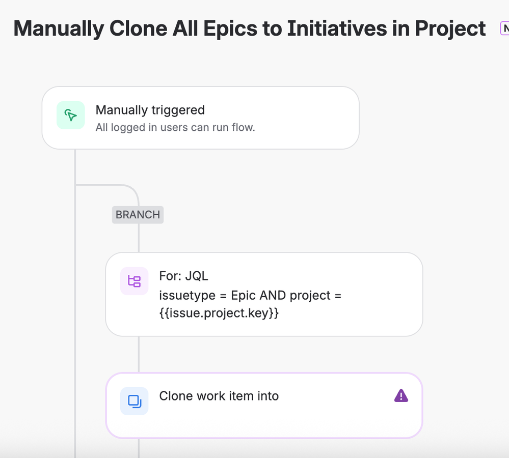

Click the Preview Flow button. Rovo will attempt to create a matching Autaomation for you. It may not be entirely complete, but it should give you a starting point. Here is what I got. Note in my system what you call a Feature is an Epic, and what you call an Epic is an Initiative.

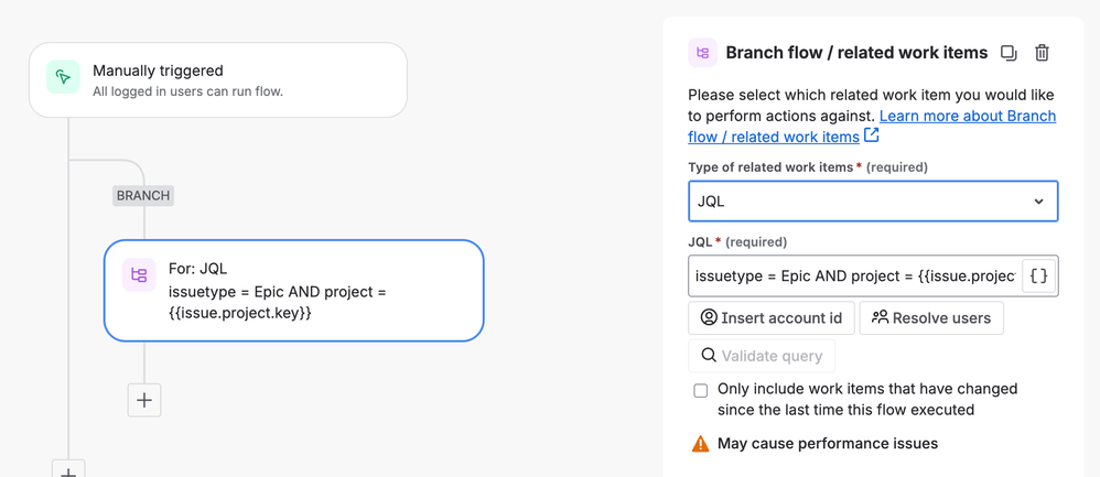

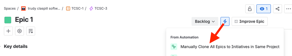

The trigger allows you to run the rule manually by selecting the rule when looking at an issue.
The next step is a For Related Issues branch where, in this case, a JQL statement is used to find the the items you want to clone.
The third step is going to clone each item found by the Branch, but we'll come back to that in a moment.

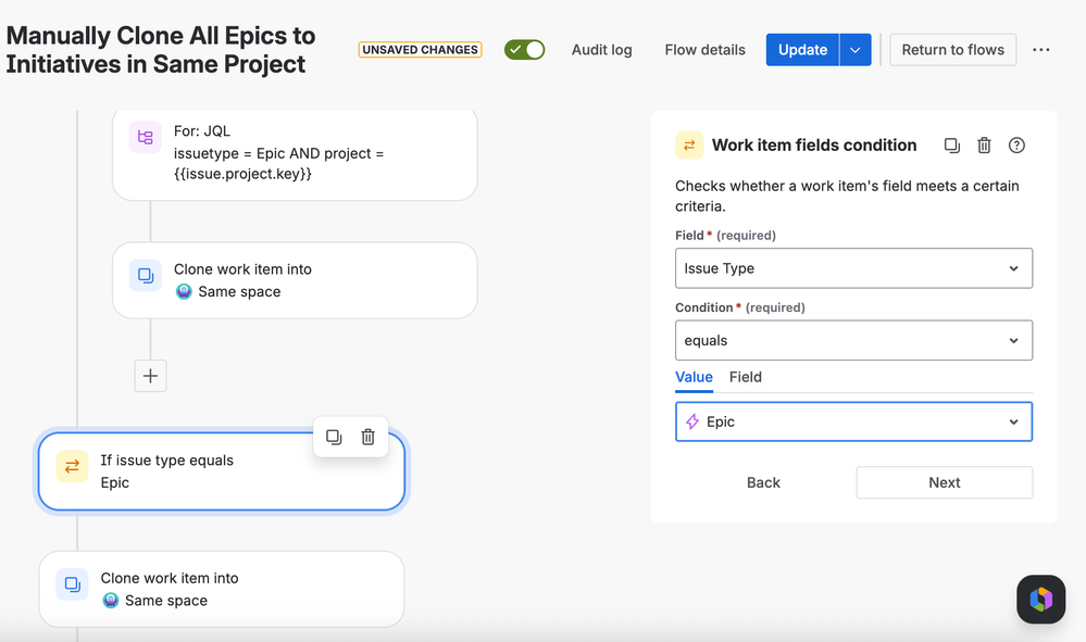

Let us first use work around #2.
Steps added outside of the For branch will operate against the item that is "in context" at that point, which is the work item from which the rule was triggered.
You want to first add a Condition to check if the work item "in context" is of the type that needs to be cloned.  If it is not, the steps that follow won't be executed.

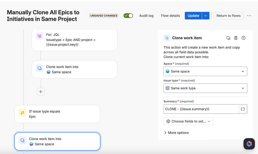

You then add the Clone action.
You get some default options set in the action - the clone will create the same type of issue in the same project and will copy only the Summary. You will need to change the Work Item field to create the type of item you want to create through the Clone action.

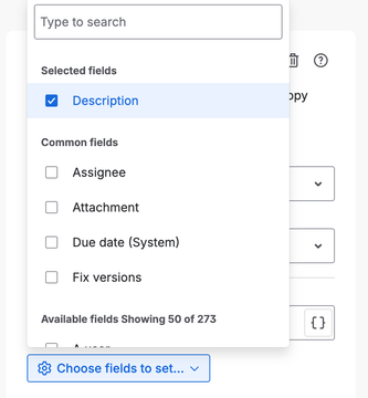

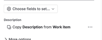

Since only the Summary is copied you will need to use the Choose fields to set list to select the other fields you want to copy and set each one. For instance if you want to copy the Description field you would select that from the list.

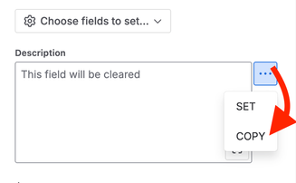

For most fields you will find an option to set the value by COPY.
When you select that a default instruction is filled in about the source field you want to copy and where you want to copy that data from.

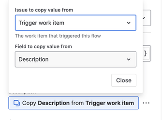

You will want to click on those default instructions so you get the pop-up allowing you to change them.
And you will want to click in the Issue to copy value from field and change that to Trigger work item for this Clone action. Then click the Close button.

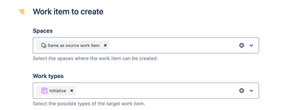

  • Define the target work item types (here Initiatives)
