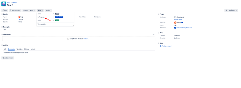

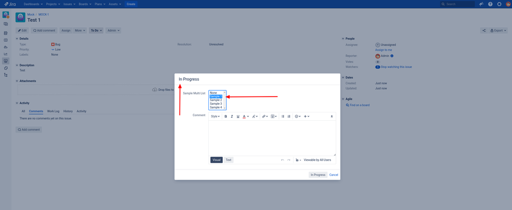

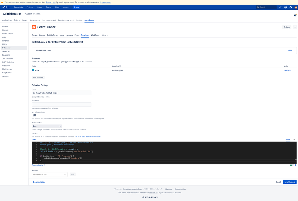

Below is a screenshot of the Behaviour configuration:-

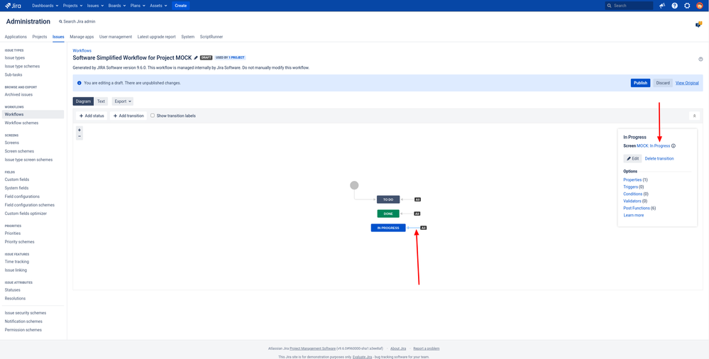

Below is a screenshot of the workflow that I am testing with:-

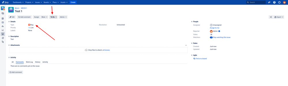

I am also including a couple of these screenshots for your reference:-
1. First, I create a sample issue of Bug-type as shown in the image below:-
2. Next, I transition the issue to In Progress, as shown in the image below:-
3. When the transition takes place, the dialog pops up, and in it, the Multi-Select List has been set to the default value Sample 1, as expected.

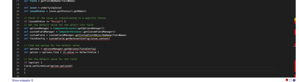

Виктория
March 21, 2023
 @Oday Rafeh
no good results...
and look like a mistakes in code (red lines on right side)
