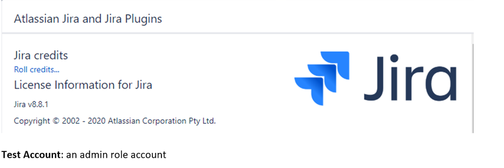

JIRA software version: 8.8.1

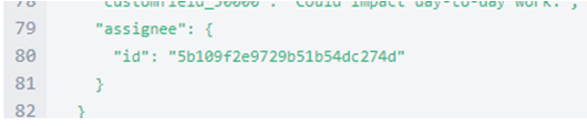

Example in Jira Cloud platform Developer REST API v2 Reference
Create issue and provide assignee with accountId

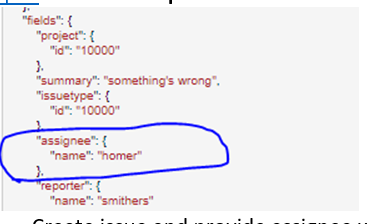

Example in Jira Server platform REST API reference(Jira 8.8.1)
Create issue and provide assignee with name
However, I encounter 2 issues in creating an issue with “assignee”:
  • I try to set the assignee with name and key, but after creating issue successfully, the assignee is not as expected (it has been assigned as the basic-auth user who post the request)

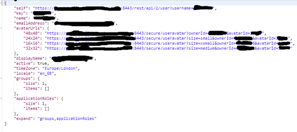

  • I try to set it with the accountId, however, no “accountId” in the response: please check this screenshotCapture.PNG

I'm now calling the REST endpoint v2 on Jira-v8.8.1

  • In the example of creating issue in both references, it set an "assignee" field in the request body, then I expect I can assign someone when create an issue. however, it doesn't work at all;
  • {Get /rest/api/2/user?key=xxx}'s response does not contain a field "accountId".

the response /rest/api/2/user?key=xxx}'s response does not contain a field "accountId". suggest it does not
