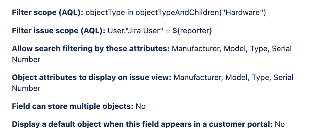

Next, you'll want to create a custom Insight Objects field and specify the AQL so it only pulls up hardware for the logged in user. An example is below:
The secret is in the Filter Issue Scope, it looks at the user attribute in the Employee Schema (which you have to get to using dot notation) and compares it to the reporter of the issue, this is what allows users to see/select their own hardware.
Your configuration may look a little different but this is more or less what you'd need to do to allow users to see/select their own hardware - for example in the customer portal.

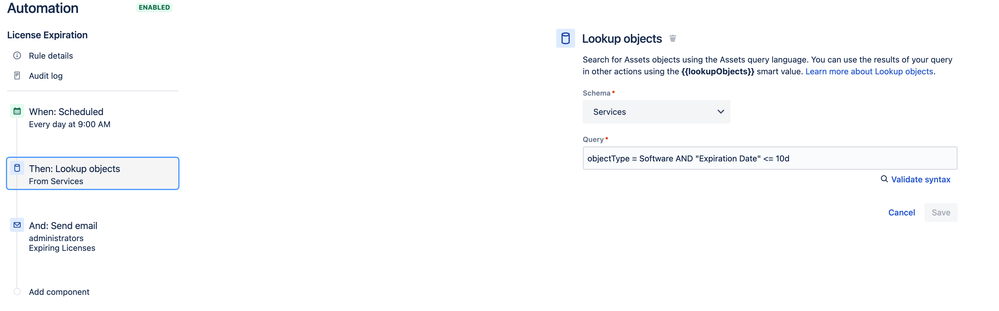

To set a reminder for when a license is about to expire, you can create a global automation rule that queries your software object type (note: you'll probably want another object type to track software). Your software object type should include an expiration date/renewal date or whatever you use to track. In your automation rule (note this must be global not scoped to a single project) you'll probably want something like this:

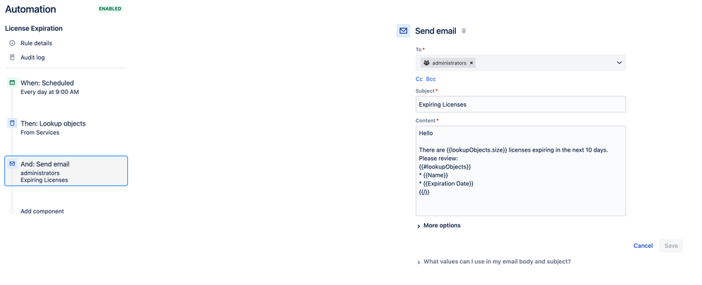

And here's an example email configuration if you wanted to email a group of people a list of the licenses expiring.
You could choose to email each user that has a license expiring, but then you'd have to change the "Lookup Objects" to "Branch with AQL".

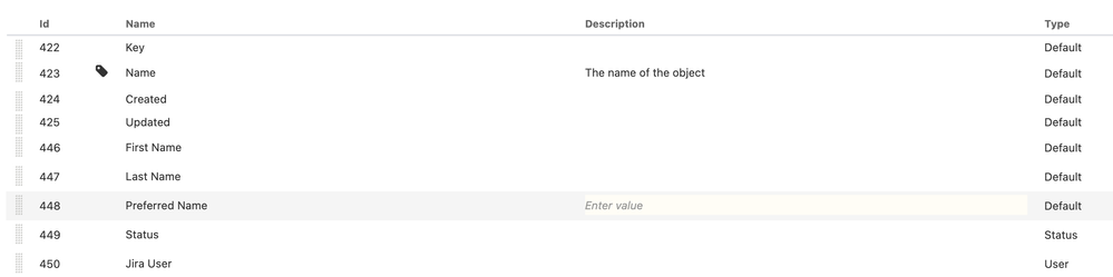

I don’t quite understand how to add users from jira to insight :)
I have to import them, how can I do that?
Thanks ^)
Like Sam Nadarajan likes this
Sam Nadarajan
October 26, 2022
Hello @v.ezersky
Because Insight is integrated into the Jira platform, any existing user accounts should be selectable in your user type field. No need to do an import unless you want to manage users that don't have Jira accounts. At that point, you'll want to use a text field.

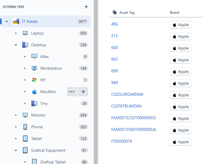

image.pngWe have updated the assets. And where can I find the list of changes please? :)
