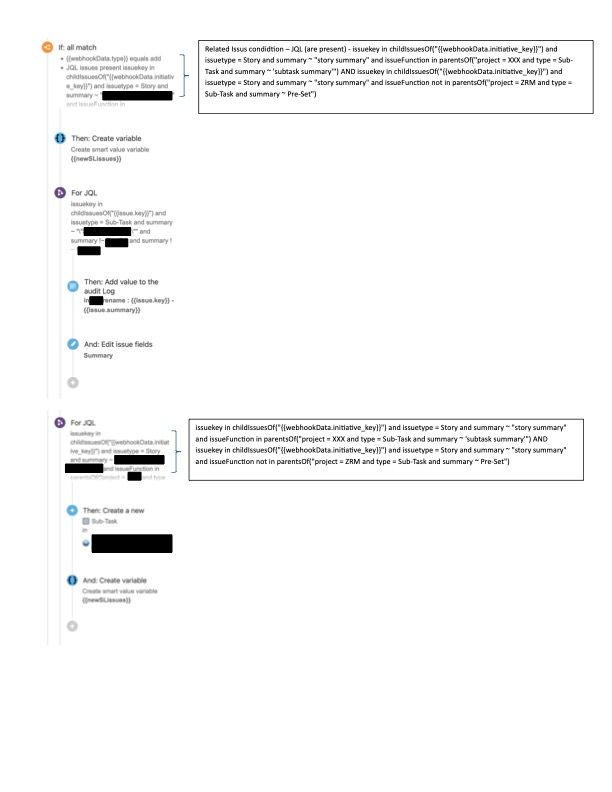

@Trudy P ClaspillThank you Trudy, I have attached the flow that is failing (sometimes) -  here is the flow -
1. a new initiative is created and during this creation a squad story and sub-tasks are created.
2. a custom field is set which in turn triggers this automation
     a. the if condition is (add a new squad, and if the squad story exists, but a specific sub-task does not exist - then take this leg. (this always passes the first pass).
3. a new squad is added to the initiative and their story / sub-tasks are created.
4. since the custom field is already set this automation runs again.
5. the if statement passes (as expected) however the identical branch fails on the second pass with:
      Branch rule / related issues
      No related issues could be found.
You might be able to convince me of a timing issue, but I would think if that were the case the initial if would have failed. The first branch (which renames an existing sub-task, and the second branch that creates the new sub-task) can execute at the same time.
So, let me throw in some mud ..
first pass - if and rename branch and create branch work (regardless of how many squads we start out with)
second pass - new squad - if and rename branch work - create branch fails
third pass - add new squad - if and rename branch work as before - create processes the story that failed in step 2 .
after that, consistency  for create branch is .. inconsistent (or i am still struggling to find a repeatable pattern)atlassian help.jpg

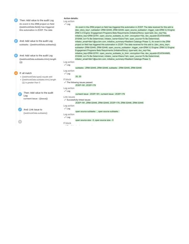

@Bill SheboyI have added logs and it writes what i expects and the branches are set up in such a way I do not car what order they run in .. the perplexing thing to me is
why pass in the if and fail on the branch, I am not changing the values that were passed in via the web hook .. I will post more data after I collect additional log information .

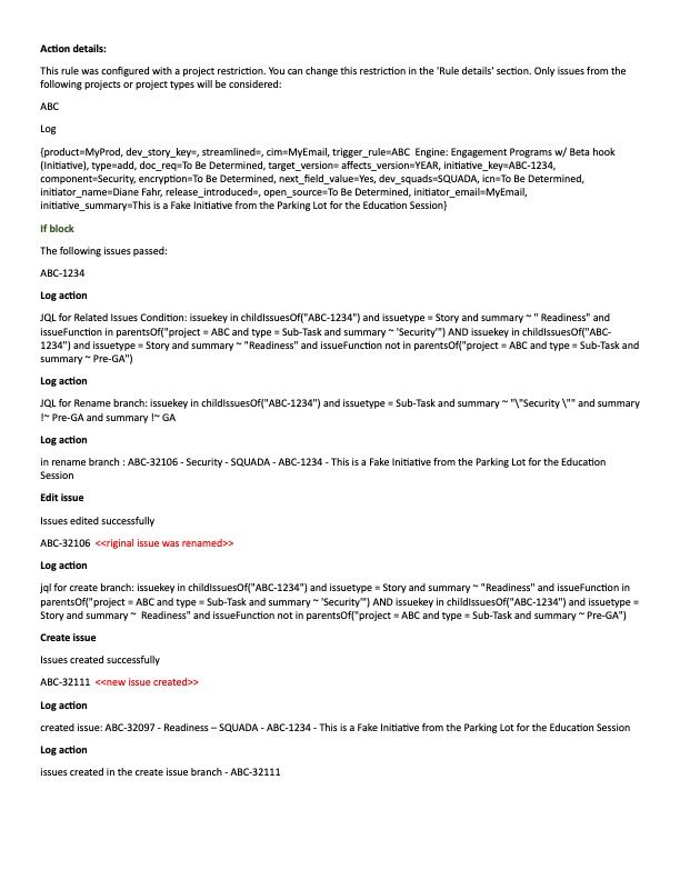

Diane Fahr
October 22, 2024
This is the first pass -
SQUAD A
  first branch renames existing issue
  second branch creates a new issue
all is right as rain .. second pass log is coming next..

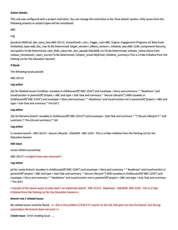

Diane Fahr
October 22, 2024
Diane Fahr
October 22, 2024
This is the second pass and as you can see the JQL resolves using an advanced search - but not in the automation. I will run the third pass, but what it will show is
SQUADC if will pass
first branch will rename SQUADC's sub-task
second branch JQL statement will resolve to SQUADB's story and create the new sub-task in SQUADBs story, however SQUADC will not get the new sub-task until SQUADD is introduced.

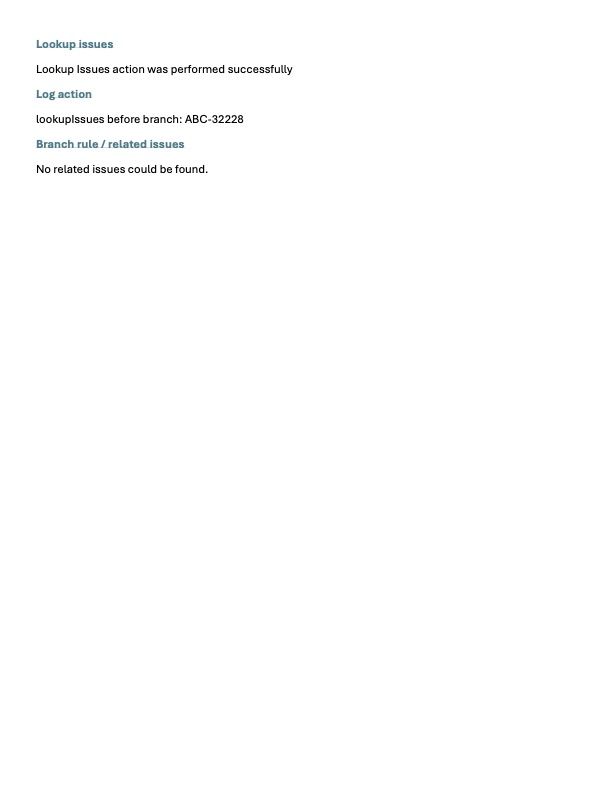

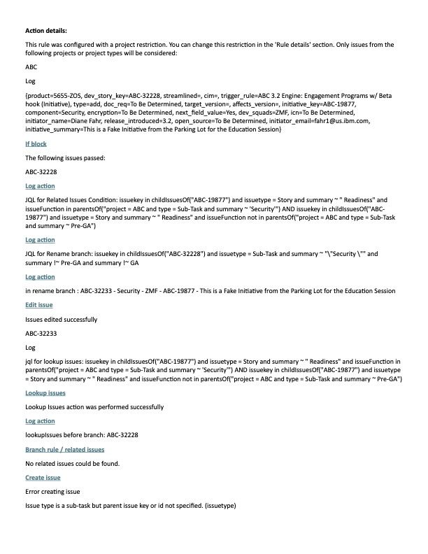

@Bill SheboyCloser!! the new issues were created (minus the first one on the list) .. having said that I am going to reset my test back to scratch and start over .. i will keep you updated.
Diane Fahr
October 23, 2024
@Bill Sheboyfirst pass .. worked as expected .. was only one squad ..
second pass .. failed .. here you go .. (the automation is the same as what I shared earlier .. this is just a snippet)
my branch is .. key IN ( {{lookupIssues.key.join(", ")}} )
Bill Sheboy
October 24, 2024
Please post an image of all the audit log details for that run of the rule.  Thanks!
Diane Fahr
October 24, 2024
@Bill SheboyMy log doesnt have a lot of details, like why doesnt the branch work .. but here you go .. 102424 atlassin.jpg
Bill Sheboy
October 24, 2024
Thanks for the log information.
Are you capturing and then editing that audit log information before posting it, perhaps to obfuscate information?
  • I note it is showing a project key of ABC for each issue and JQL expression
  • Specifically I want to know if all of the issues this rule could operate upon are in one, single Jira project?  The rule scope is single project, and it will not be able to access issues in other projects: the scope would need to change.
Next, the trigger issue for that rule execution appears to be "ABC-32228".  And, the issue the JQL branch is trying to access is the same one.
  • Is that what you expected?
  • JQL Branches cannot branch to the trigger issue.  My understanding is rule branching adds a clause to prevent this to avoid errors.

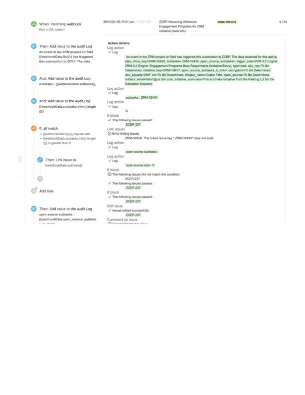

Diane Fahr
October 29, 2024
@Bill SheboyI cannot create a rule that runs directly from a trigger - my rule is called by a webhook.
So taking a step back, this is the flow.
- We have a custom field that contains all the squad names that are working on that initiative.
- We require at least one squad name before the initiative moves to discovery.
- Upon moving to discovery we create a structure for each squad that contains a story and several sub-tasks.
- One of the squads indicates this initiative will be provided to clients early by setting another custom field, called CLIENT.
- this kicks automation to run - which runs a rule that creates an epic to track the work and runs a second rule that renames and creates the new sub-task (this comes from the rule i have been sharing).
- everything works fine on this first pass, regardless of how many squads there are.
- a new squad (SA) is added which triggers a series of rules that creates that squads story - sub-task structure, and because CLIENT is set, the rule I have shared with you is executed. This is the first squad add, and eventhough  you can get the story key a number of ways, branching on the story key fails (as the logs from before show).
- if I add yet another squad (SB), and the process runs again, the branch on the story passes because it finds SA and not SB.
- this trend continues for as many squads as I add.
Other things to note:
- the branch on the sub-task (to do the rename) always works and this is under that new story.
- if I add two squads at the same time, both squads will be processed .. but if i follow adding two, by adding one (the final one will fail on the branch).
It is not possible to call the rule based on a trigger from an issue.
I have been able to get the story key in the calling rule and pass it via webhook. I have taken the branch out of the if statement and make it the first thing that is processed, and even though i am passing in the key to branch on - it works as I describe above.
If it is a timing issue, something hasnt synced? or something? even though the lookupIssues finds the key but the branch cannot find the key, is there something that can be done, a delay, a something?
Like Bill Sheboy likes this

The initiative starts in To Do and at the time of transition to Discovery the field that holds the squad names (one or more) must have at least one.  When the initiative is in Discovery is when the story / sub-tasks need to exist.
The trigger to transition from To Do to Discovery is a manual trigger, after transition the trigger is a new squad being added to the list of squads.
The Client field is set when the team determines they will provide early code - in other words, can be anytime.
We are hoping Jira Cloud becomes available to us sometime in the near future, we have very little (no) control of the environment and that can make things difficult.
I want to play a bit more with this .. im trying to decide if i know at any given point what my trigger issue is .. i dont think i have the problem when the trigger is the initiative, but i have the problem when the trigger is the story ..
  • if / else
    • condition: the issue to branch-over is the trigger issue's key
      • branch: on current issue (i.e., the trigger issue)
        • action: do stuff
  • else
    • branch: on JQL
      • action: do stuff
Bill Sheboy
October 29, 2024
As you already have a rule started, try that last bit to see if it helps with the Initiative vs Story as the trigger.
If not, I could envision 4 rules:
  1. triggered on the Initiative transition to Discovery, call the recursive rule #2 to create the Squad issues
  2. triggered on incoming webhook, add one set of Squad issues, and recursively calls itself using Send Web Request, until done
  3. triggered on a change to the Client field, do what is needed
  4. triggered on a field change to Squad after the Initiative is already in the Discovery status, use the changelog / field change smart values to detect additional Squads added, and then call rule #2, as needed
Of course, if the number of Squads is fixed and less than 20, a ginormous if / else block could be used to add their issues, without the risks of recursion.  That block would be replicated in rules #1 and #4.
Diane Fahr
October 29, 2024
@Bill SheboyIs there a handy dandy way to get a list of issue minus the trigger issue?  I have played with lookupIssues replace triggerIssue with "", but either that is not possible or i do not have the correct syntax .. so i was curious if there was another way to get the list - trigger?
Bill Sheboy
October 29, 2024
Yes...you may add this to the JQL for the Lookup Issues action to exclude the trigger issue:
 AND key!={{triggerIssue.key}}
Diane Fahr
October 29, 2024
@Bill SheboyI think I realized although I heard what you were saying, i wasnt really getting it .. but the gist is this
You cannot branch on a trigger issue
You can perform operations based on the trigger issue by using an IF statement
Since your rule may either trigger from an initiative or story you have to handle both cases because you always want the subtask under the story ..
so .. if the trigger issue is a story .. create a subtask and save that value in a variable
if it is an initiative .. branch on the story and create the subtask and save the variable ., do a few other things then use a webhook to send data to another project area
however, your first IF statement may not have completed, and your second IF statement triggers the webhook but you dont have the data from the first IF
and all. of this because you cant branch on the trigger issue and you cant control the flow of the automation
that is a big sigh from me :-)
Diane Fahr
October 29, 2024
@Bill SheboyI had some success with initial testing and it was all because of not being able to branch on the trigger issue  ..
having said that, I have another question for you and I am assuming it is a similar problem to not being able to branch on the trigger issue, this time is is trying to link. I have a webhook that calls another project and send the issue number .. I log the issue number, the issue size (for no reason other than i wanted to convince myself it wasnt 0) .. but when i try to link the rule believes the issue does not exist .. here is the log.. is it the same problem as above, but with links this time?

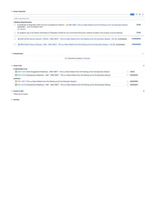

Bill Sheboy
October 29, 2024
Just to clarify, a rule cannot use a branch on JQL to the trigger issue (because the rule automagically adds a clause to the JQL to remove it).  Other branch types will work with the trigger issue.
For the linking symptom, in that log it appears the issues are in different projects.  What is the scope of the rule: single-project, multiple-projects, or global?
A single-project rule cannot access issues in other projects for linking, reading, etc.  (It can only create or clone into other projects.)
Diane Fahr
October 29, 2024
@Bill Sheboythank you for clarifying .. i did test with link on current issue, but since the trigger issue can be an initiative or story i can control where the new sub-task is linked .. regardless I think i have it navigated .. having said that -  the linking is weird, sometimes it works and sometimes it does not .. we are mulitproject and all our development projects are in a category.  we use webhooks to communicate with other projects and send the data that way.. I will admit we have a pretty complicated automation solution ..
regardless,  we do take advantage of liking other projects to our initiatives .. here is an example .. sometimes it does work and sometimes it doesnt .. ill play with it .. i really appreciate all your help, i have been stuck for a couple months :-(atlassian.jpg
Diane Fahr
October 30, 2024
@Bill Sheboyand just so you dont think i am crazy .. this morning the links worked .. atlassian link example 2.jpg
Bill Sheboy
October 30, 2024
Perhaps compare the specific issues (and audit logs) for the cases that worked versus those that did not to help pin down the root cause.
And as an FYI when posting the images, please try to post them at a higher resolution and remove the extra blank space at the bottom.  That will make it easier for the community to see the details.  Thanks!
