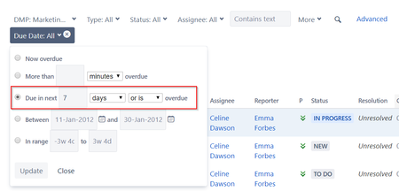

Bogdan Gorka
May 6, 2019
Use the simple search engine and select your options
Then, if you select the Advanced option, you will see how it translates into JQL.
In my example it was:
project = DMP AND due <= 7d
 More about comparing fields with operators can be found here: https://confluence.atlassian.com/jirasoftwarecloud/advanced-searching-operators-reference-764478341.html
