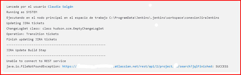

Hello dear community, I have the same question as the collaborators, and when I try to update the status of the cards in Jira through Jenkins I find the same error attached screenshot below.
.i don't have the jenkins server deployed in any cloud(is this necessary?)
i.e. my jenkins server is local.
.i have saved in the credentials of my jenkins server the API Token and the Jira username(this is what guarantees me that if it connects)
Anybody had a solution ? thank you very much and greetings!
