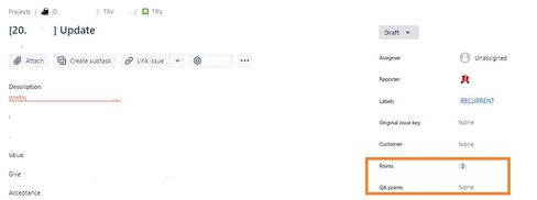

as per the below screenshot, I have 2 fields for points:
- points: are the workdays for DEV
- QA points: are for QA team workdays
I would like to see a total point field where it can display the sum-up of the 2 points fields
=> I will be able to better see total estimated days of work
How can I do that (I am on JIRA Cloud)
thanks

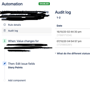

Once you start to create your rule, and once you have set a trigger, you can add a "new action". Here you can select the "Edit issue option".
Let me know if you succeeded i can help you ;)

Ok so if your rule fail, you can share the audit log to understand better the problem, it is here :
Don't hesitate i can help you untangle this ^^
