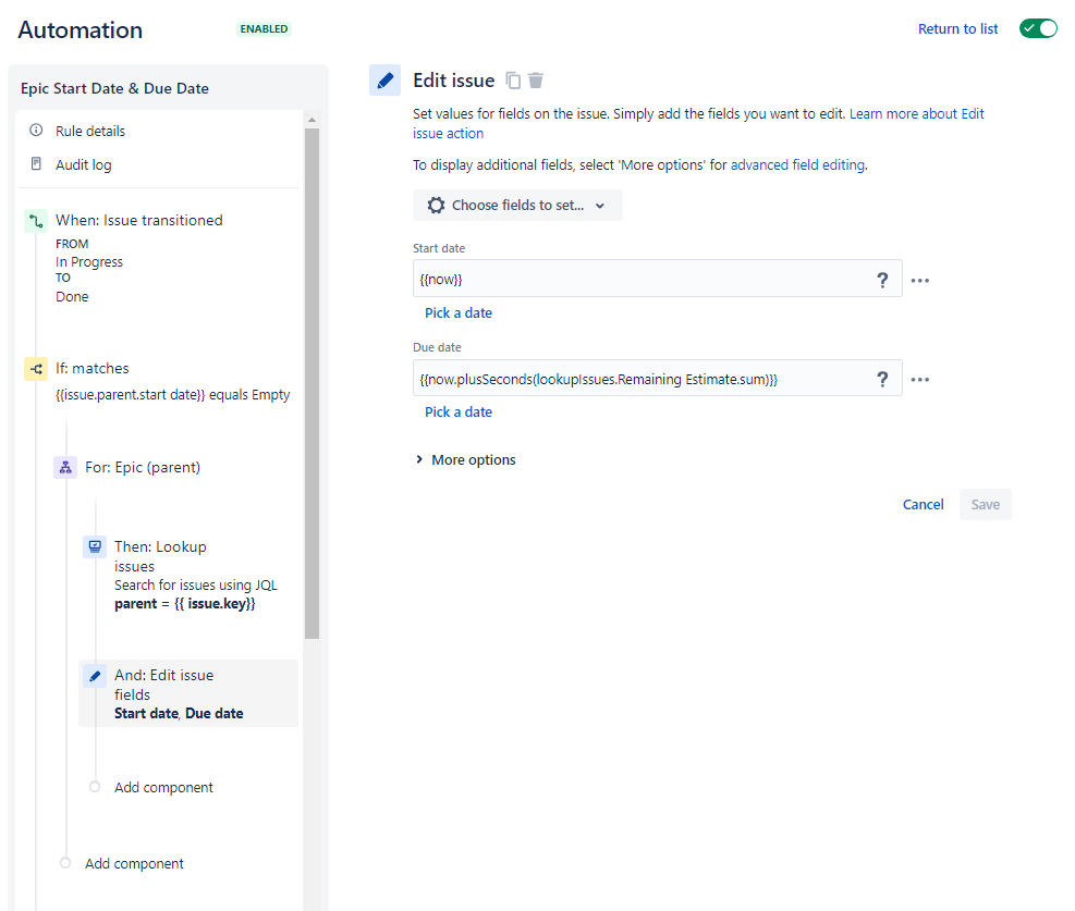

Trudy Claspill
October 12, 2023
At this location
...insert a Lookup Issues action.
Remaining Estimate is stored as seconds. So if you want to set Due date to now() plus the remaining estimate sum of the Epic's child issues (found in the Lookup Issues action) then use this smart value:
{{now.plusSeconds(lookupIssues.Remaining Estimate.sum)}}

@Bill Sheboy , I am not sure what you meant by edit both Start Date and Due Date in one single edit.  How do we do it? I don't see the option in the Automation to do so. Could you please kindly advise? thank you.
Trudy Claspill
October 12, 2023

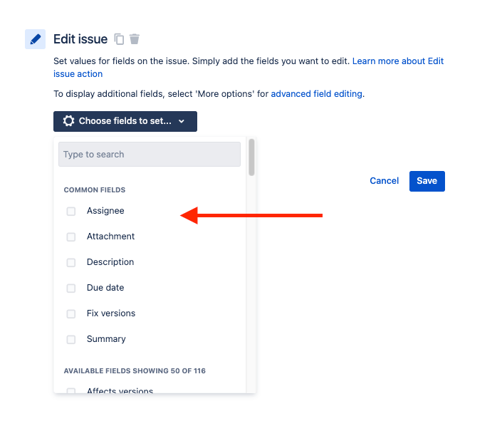

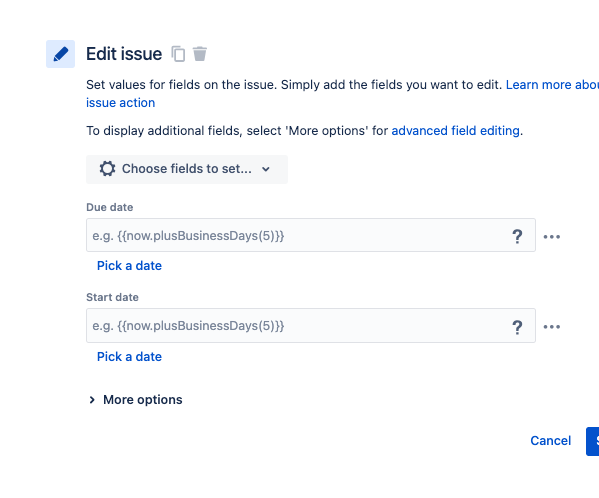

In one Edit action you can edit more than one field.
Just select additional fields to edit.
Screenshot 2023-10-12 at 12.54.30 PM.pngScreenshot 2023-10-12 at 12.55.16 PM.png

@Trudy Claspill , I was able to get some progress and get close to the end goal. At least it does not error out in Automation. Having said that, I see the Due Date field does not seem to get the correct value.
When I run the Automation, the Epic (Parent) issue Due date shows as 3 days from the Start date which is way off the total number shown from the JQL which shows as 8 days.
Where did I do wrong? Am I missing something?
Thank you.
Kent

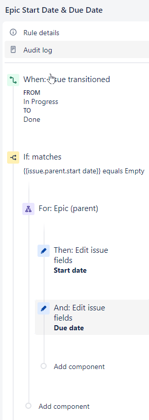

Kent, would you please show an image of your current, complete rule, and of the details of the edit issue action?  Those may help explain this difference.  Thanks!
Like Trudy Claspill likes this
Kent Chiu
October 12, 2023
Hi  Bill, here is the complete Automation rule. Thank you for being so helpful.

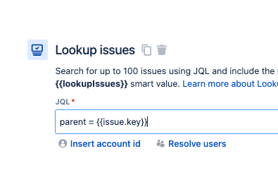

Kent Chiu
October 24, 2023

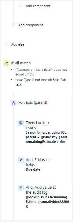

@Trudy Claspill , Sorry to bother you. Is there a way to lookup issues to exclude child tickets that don't have the remaining estimates (I.e, either empty or 0h)?
Due to the limitation of 100 issues per lookup issue, I am trying to reduce the number of the lookup issue to less than the limit.  Most of our Epics have more than 100 child issues.
I have tried different ways to add the condition:
1. "remainingestimate is not empty"
2. issue.fields.remainingestimate}} is not empty
on the lookup issue
parent = {{issue.key}} and one of the above condition
Automation didn't take it.
I really appreciate your help.
Thanks,
Kent

Kent Chiu
October 24, 2023

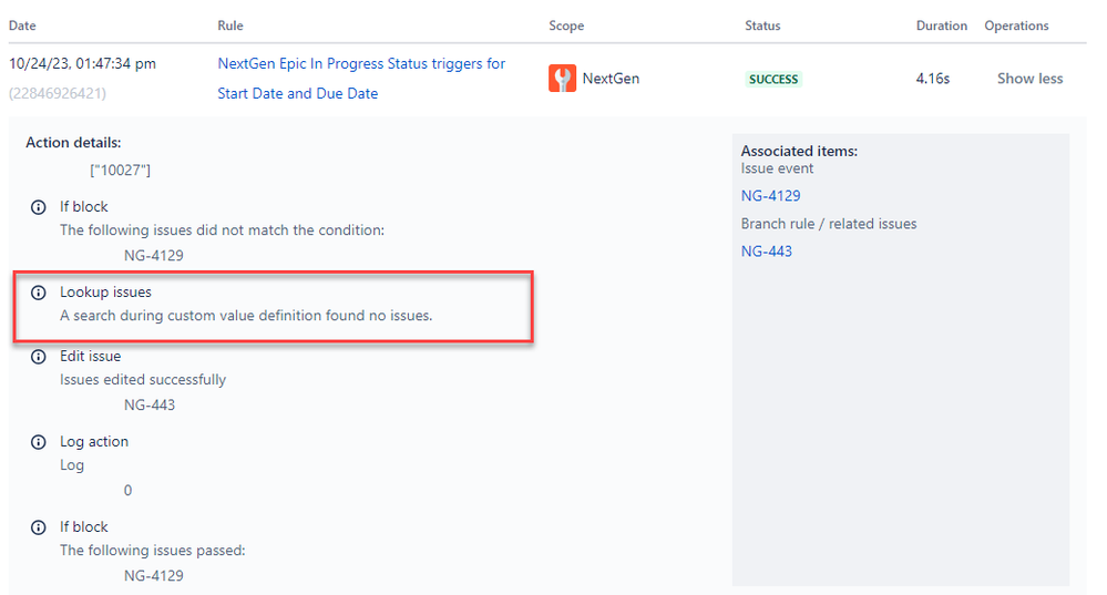

It is not working.  Here is the audit log.
I tried it in the production Epic. It has 166 issues. The ones that have remaining estimates are only 20 tickets.  However, with the additional condition, it didn't work.
I created a child issue with no original estimates (i.e. 0 remaining estimates). The result of the run came up 0 day which should be 12.104 days in total from 20 issues.
Thank you for your help.
Bill Sheboy
October 24, 2023
I wonder...should the JQL test if the remaining estimate > 0 rather than just not empty?  A 0 value would appear as "not empty".
Kent Chiu
October 24, 2023
Hi @Bill Sheboy , Thanks for providing a suggestion. I tried that but it is still not working.

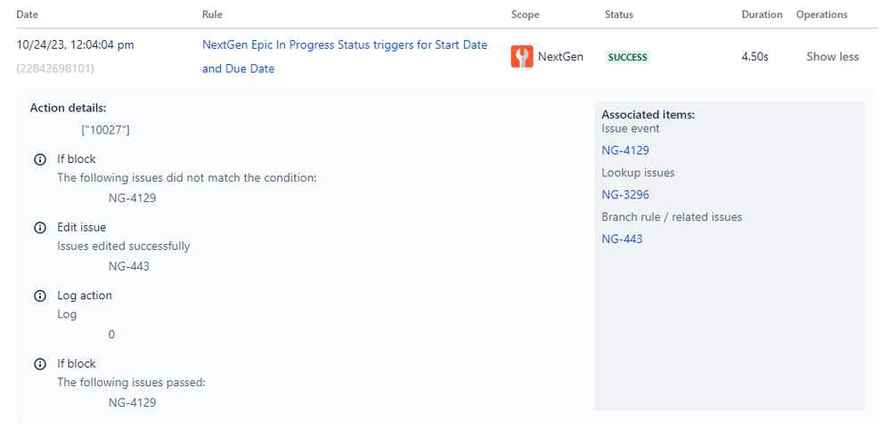

Here is the audit log:
Bill Sheboy
October 24, 2023
Do you see the typo in the Lookup Issues JQL, where there is a space after the curly bracket?  That may be evaluating to parent = null...
Please try removing that extra space.

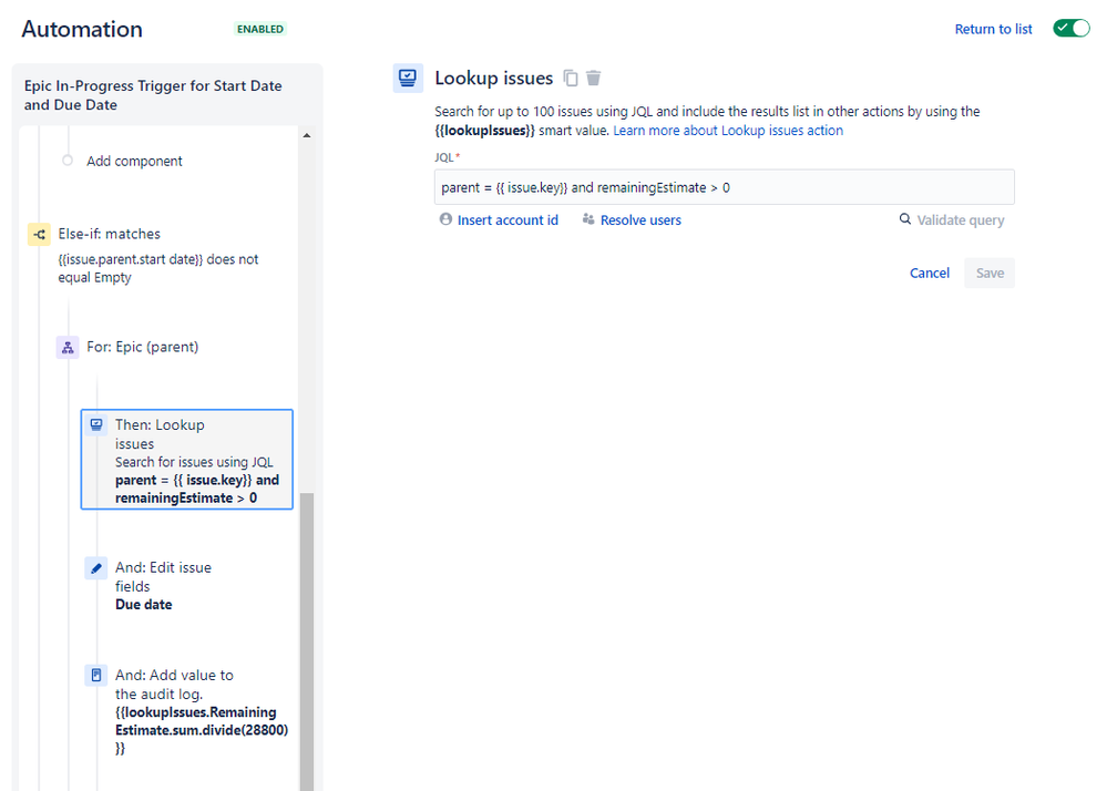

Kent Chiu
October 24, 2023
@Bill Sheboy , I corrected the typo but it seems to have no effect on the execution.
Bill Sheboy
October 24, 2023
Pausing for a moment, if you run a stand-alone query in View All Issues with the following, what do you observe:
parent = NG-443 AND remainingEstimate > 0
Kent Chiu
October 24, 2023
@Bill Sheboy , That JQL came up with 0 results.

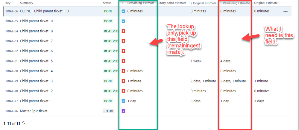

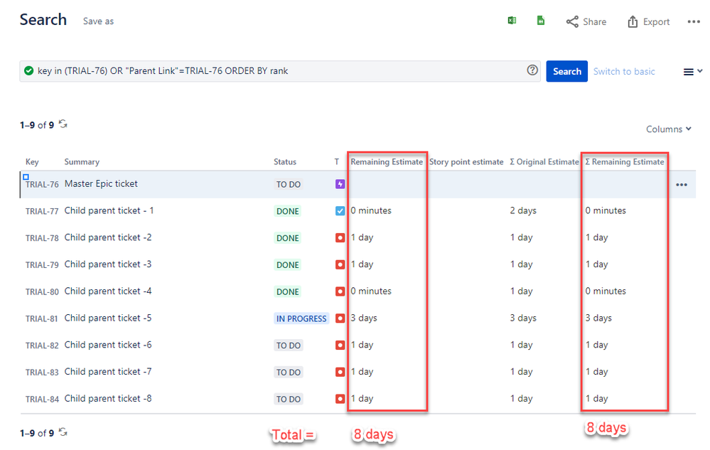

I think I found the root cause of the issue. The reason it came up with 0 results is none of the Child tickets' original estimates have a value set. they are all empty (i.e. shoes as 0m)
The remaining estimate that I mentioned earlier (20 issues), they are all comes from the aggregated remaining estimate from the child ticket's subtask issues.
e.g.:
The question is we don't usually set the original estimate on the Child tickets. We keep all the time tracking on the Sub-tasks issues. Is there any way we can retrieve the aggregated remaining estimate of the child tickets that were derived from the sub-task issues?
Any suggestion?
Thank you.
Trudy Claspill
October 24, 2023

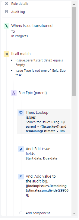

I'm a little confused myself in comparing the Audit Log output to the structure of the rule
Rule structure:
Trigger
If condition
For Epic
Lookup Issues
Edit Epic
Else-If condition
For Epic
Lookup Issues
Edit Epic
Log information
The log output indicates that the first condition is not being met by the trigger issue, but the following messages indicate the a Lookup Issues is being executed and finding no issues, and then the Epic is being edited anyhow. And then there is a Log action occurring, and then another Condition evaluated.
I note also that the you are using the JQL in two Lookup Issue actions, and the typo existed in both based on earlier images. Did you correct both?
Can you show us the entire rule as it currently exists and the entire Audit Log entry for an execution of the same rule.

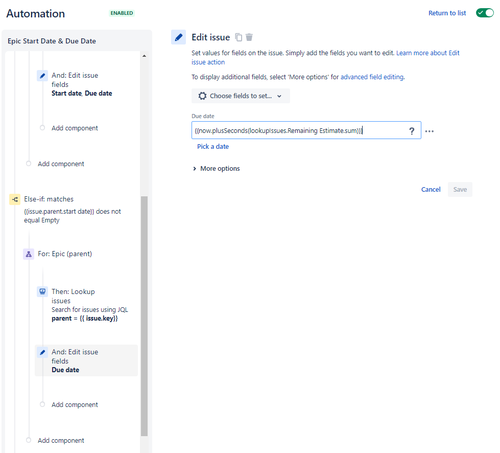

Kent Chiu
October 24, 2023
Hi @Trudy Claspill , You are correct about the Rule Structure.  I think the issue is none of the child issues have the Original Estimate. They are all empty. The JQL in the lookup issue only picks up the child issues' Renaming estimate (it does not consider the aggregated remaining issues from its subtask).
I am completely lost now on how to update the Epic Due Date with the SUM of the child issues. We only track the time in the subtask tickets. We don't usually use the child issue's Original estimate. it is all derived from the child's issues time tracking.
Here is my automation rule:
Thank you.
Kent Chiu
October 24, 2023
@Trudy Claspill , Your rule structure is correct. I think the issue here is the query does not pick up any child issue because it does not have the Original Estimate value. Thus the remaining estimate is empty/0m.  If the child issues' Original Estimate is not empty is seems to work.
How can we get the Sum of the remaining (including the aggregate from the subtasks) the one highlighted in the red box?
Thank you.
Trudy Claspill
November 3, 2023
Hello @Kent Chiu
The summation value you highlighted is not actually a field available in the issue that you can reference in Automation.
I have not worked through all the details, but I suspect that the only way to have access to that information is to actually copy the sum of subtask remaining estimates up to their parent issue.
However, if you sum up the remaining estimates on the subtasks and update the parent issue's Remaining Estimate field, then for the summation value you will get the Remaining Estimate sum from the subtasks plus the Remaining Estimate sum in the parent issue.
So, you would need to store the subtasks' remaining estimate sum in a separate custom field in the parent issue.
You would need a rule triggered by logging work on the subtasks, which would then recalculate the sum of the remaining estimates on all subtasks and update the custom field of the parent.
Then your existing rule would need to be changed to look at that custom field instead of the system field for Remaining Estimate.
