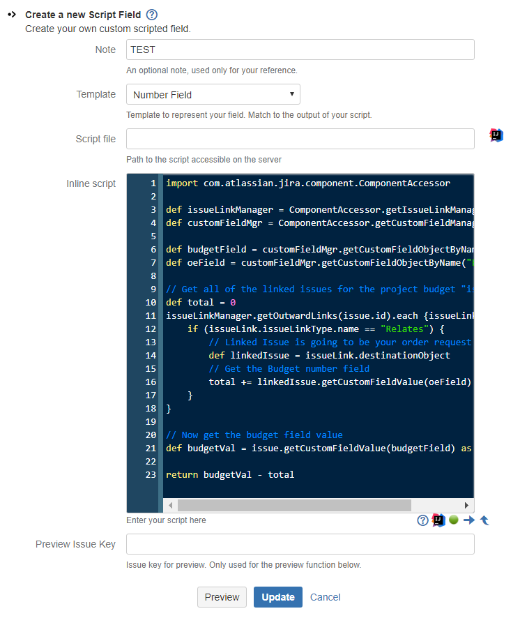

The setup for my field is:
If you want to let me know what issues you are having then I am happy to try to help you through them.

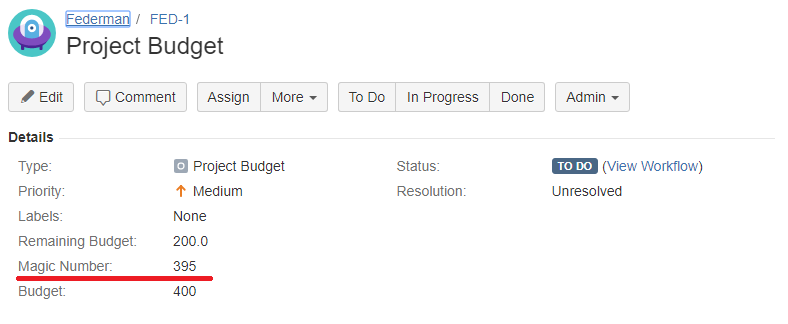

Just a quick update, here is a screenshot of it working on a basic test project. The issue that has the expense has a value of 5.

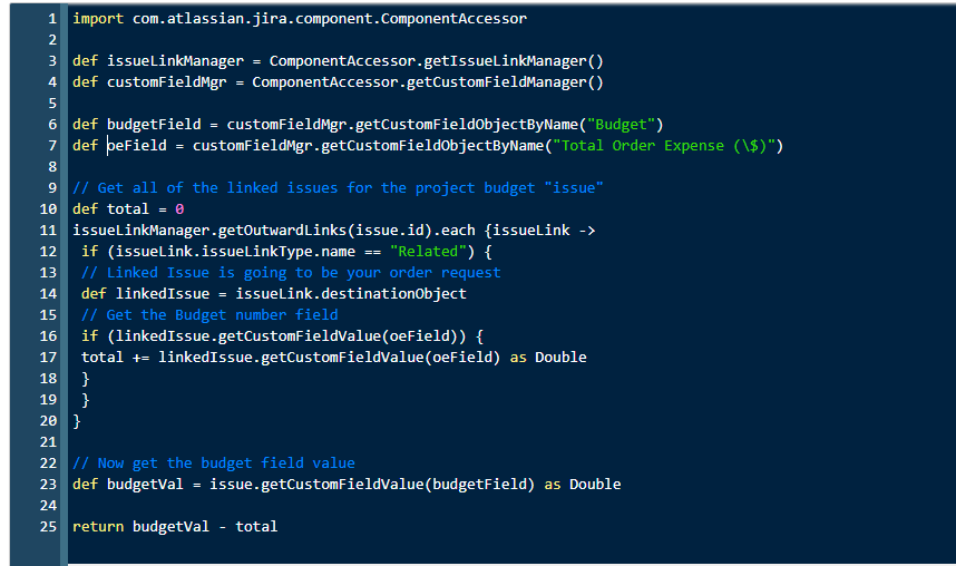

I also just realized you are pulling expense not Total Order Expense ($). Will that make a difference? The Expense field is on the the subtask of the order request.
That will make a big difference, in my test setup I called the field “Expense” for simplicity’s sake. I can see from your given examples that you want to use “Total Order Expense ($)” :-)

i just realized i needed to add the slash before the $. I did this and the remaining budget field cam back but it is still showing the same number as the budget itself. and im still returning this error
2017-12-13 10:10:05,187 ERROR [customfield.GroovyCustomField]: ************************************************************************************* Script field failed on issue: OPS-616, field: Remaining Budget java.lang.NullPointerException: Cannot invoke method minus() on null object at Script184.run(Script184.groovy:25)

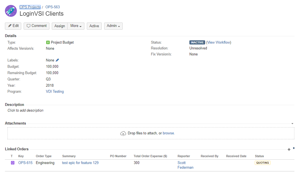

There are two things here that don't quite line up. In your error, it states:
The error in your screenshot the parent issue is OPS-563 and the linked order is OPS-615. This would indicate that this is for another issue.
The fact that a number is being returned for Remaining Budget, suggests that the script is running fine, but that it is not picking up the linked order. Is there a way to confirm the link type of the linked order? This does not look like a standard JIRA link.

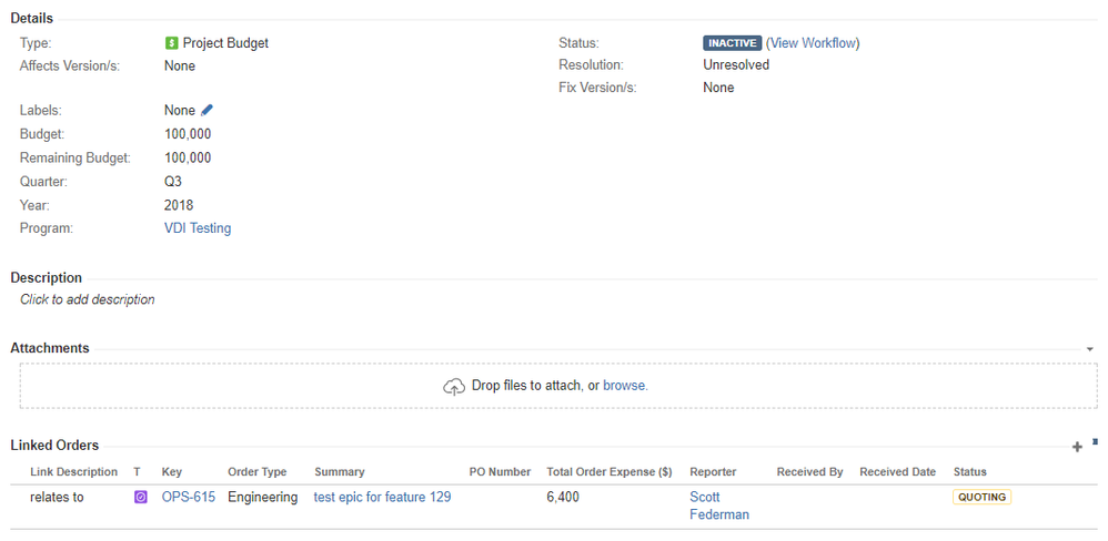

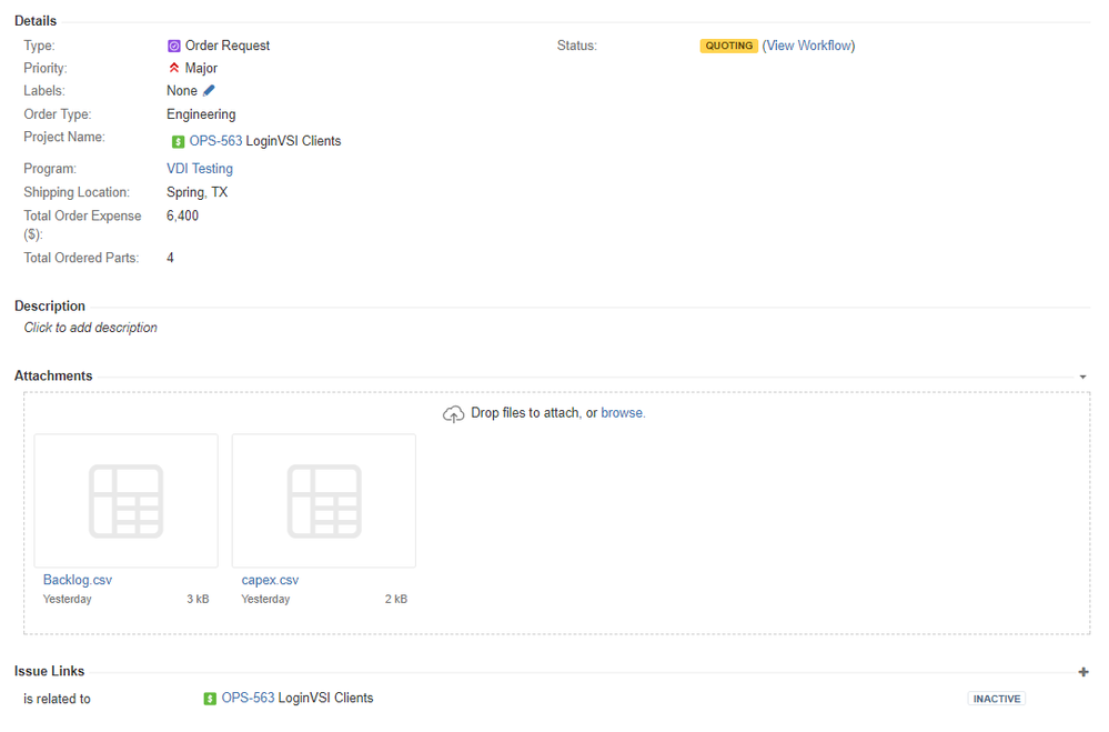

yes i was just looking at it and realized the outward link type is "is related to" so i changed that and im no longer throwing errors but i am still returning the same value as the budget field.
Could this be because its looking for the total order expense ($) which is a scripted field that is generated by summing up the expense field in the subtask, which is a calculated field based on quantity and unit price?

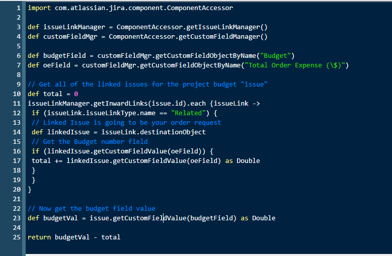

Hey Stephen, welcome back. Hope you had a great holiday and vacation.
SO i looked at that as well as the result did show inward linking, however the script itself says its looking for outward just as you suggested.
Absolutely, that's my point. I didn't realise before that we were dealing with inward links. Do you get the expected result if you switch the script to look for inward links??
Nope. Unfortunately. It does the same exact thing. But now it throws the error
The following log information was produced by this execution. Use statements like:log.info("...") to record logging information.
2018-01-03 09:22:01,455 ERROR [customfield.GroovyCustomField]: ************************************************************************************* Script field failed on issue: OPS-728, field: Remaining Budget java.lang.NullPointerException: Cannot invoke method minus() on null object at Script96.run(Script96.groovy:25)
I’ve setup a mock environment with your use case again to get this straight. I’ve spotted two issues, which I hope that when solved, will fix this script for you.
The null pointer exception you are getting states:
I am certain that this is because it cannot find a value in the budget field on the “Project Budget” issue that the field is running on. I have reproduced this issue in my local environment, and get the same error as you. As soon as I put the budget value back in, I get the correct values and response back. You need to triple check that the issue you are testing with, definitely has a value in the budget field.
We have had a continuing theme that we can’t seem to get the subtraction to work. You always appear to end up with the “Remaining Budget” matching the “Budget”. I’ve done some investigation on this and this is happening because we are looking at the wrong side of the budget for the expense value.
In order to solve this issue, if you switch to looking for inward links, then you need to change this line:
def linkedIssue = issueLink.destinationObject
To this line:
def linkedIssue = issueLink.sourceObject
I hope this helps clear up your issue.
ding ding ding!!!! Nice one. It is working. Thank you for everything on this. HUGE HELP.
Yey!!! We got there in the end :-D

def total = 0
issueLinkManager.getOutwardLinks(issue.id).each {issueLink ->
if (issueLink.issueLinkType.name == "Related") {
// Linked Issue is going to be your order request
// Get the Budget number field
total += linkedIssue.getCustomFieldValue(oeField) as Double
// Now get the budget field value
def budgetVal = issue.getCustomFieldValue(budgetField) as Double
return budgetVal - total
