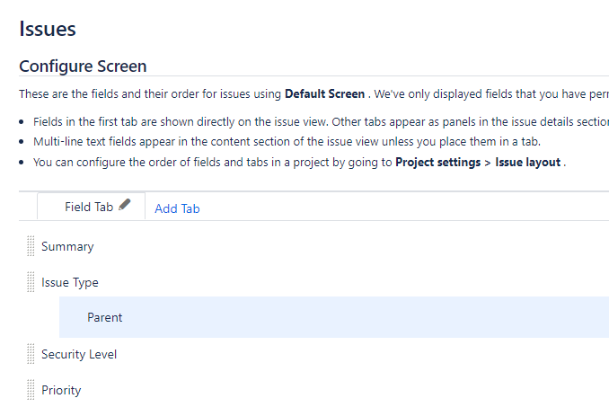

You should change the order of the fields on the create screen itself. Go to Settings > Issues > Screens and search for the create screen used by the project. Then reorder the fields on this screen.

The EDIT and VIEW screen fields are ordered as described in my comment above (https://community.atlassian.com/t5/Jira-questions/Re-Re-how-to-order-fields-in-create-issue/qaq-p/2733725/comment-id/1027982#M1027982). However for the CREATE screen, it's in the screen itself as described by @John Funk. It's just not obvious that you're affecting the CREATE screen directly from there, I think.
So while in your Jira project, click on Settings (cob wheel) > Issues > Screens, from there look for the screen in question, click on it and you'll land on a page called ISSUES (Configure Screen) in which you can reorder the fields. It just so happens that it's also the spot from where you make the fields visible of not.

Alain, I've found the screen you're referring to but still can't seem to make it work. I have a few different screens, I assume the one I should be looking at is "Default Screen". I've updated the order of the fields to my preference but when I go to create a new issue, the order is not obeyed.
I'm not sure what I've missed. Any help would be appreciated.

I can find the screens through this path instead:
I found this screen following your earlier instructions as well, and re-ordered the fields there as well but it didn't seem to take.

What I'd like is to put the parent field front and centre, as I can't make it a mandatory field. But I've reordered my fields, and the only schema attached is "Default Screen Scheme".
But even so, when I go to the create screen, the Parent field is way down the screen.

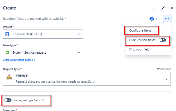

Same problem here we are able via the "Issue - Configure Screen" to configure which fields are shown in the creation screen for the given issue type, but the order how fields are shown in JSM is not affected.
Hi, just noted that once you specified the fields and their order in "Issues - Configure Screen" there are still the following options that changes the behaviour which fields are shown.
- "Use request type fields": if switched on you need to "open portal" to have the fields show. Suppose here it is switched off to use the definition of the issue type create screen
- "Configure fields": in order to specify if all fields are shown or only a few. Specify "All fields" if you want to see them all
- "Hide unused fields": if switched off all fields defined in configure screen are shown in the defined order.

Configuring the fields allows me to select some or all fields, but not the order. Hiding unused fields similarly doesn't affect the order.
Finally, I don't have a toggle for "Use request type fields". I suspect it's because I don't have Request Types enabled in my project.
