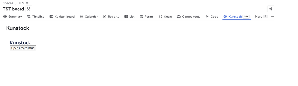

I've been investigating how you can do it, and I've created a tiny app just to show you how you can add a button to create an issue.

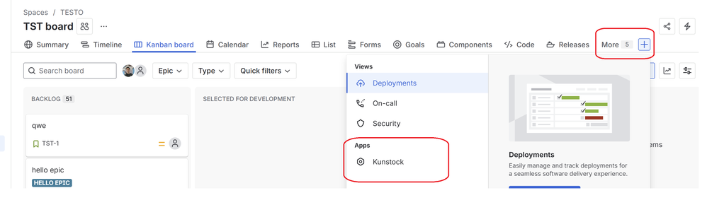

After I've deployed the new app created, I can see my app listed in here as I've selected "Jira project page" template, so a page in the Project page will be shown.
Then, after it was added, I can see the button that I've added as part of this example

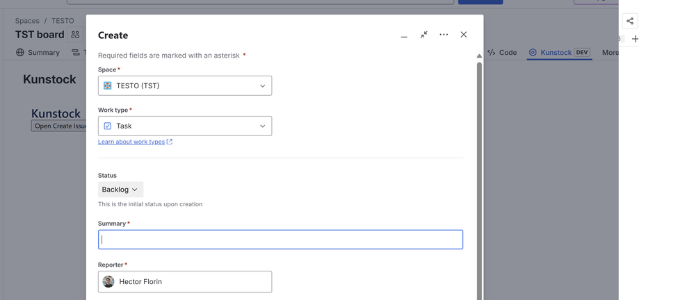

On which, if the user clicks on it, it'll open the create work item screen.
So, either you build your own Forge app to do it , or you will need to use a Vendor's add-on that can allow you to handle Jira Cloud UI
