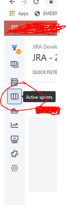

hello ,
i want to hide " active sprint " which is shown in figure . using javascript (web resources)

Hi @sgole,
I tested this on browser Console and it worked:
$("[data-link-id=\"com.pyxis.greenhopper.jira:project-sidebar-work-scrum\"]").remove()
I hope that this helps.

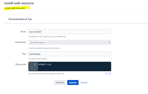

sgole
February 25, 2021
hii @mogavenasan ,
i have create fragment- web resources like below .
and in HideCf.css i have written ,
but it wont work .
mogavenasan
February 26, 2021
Hi @sgole,
I don't think jQuery commands should be placed in a stylesheet file (.css). And this Install web resource - is this from Scriptrunner?
Are you sure you are using this function correctly? You might want to refer to this doc for a better understanding. For the Context(s), how did you deduced to jira.view.issue
