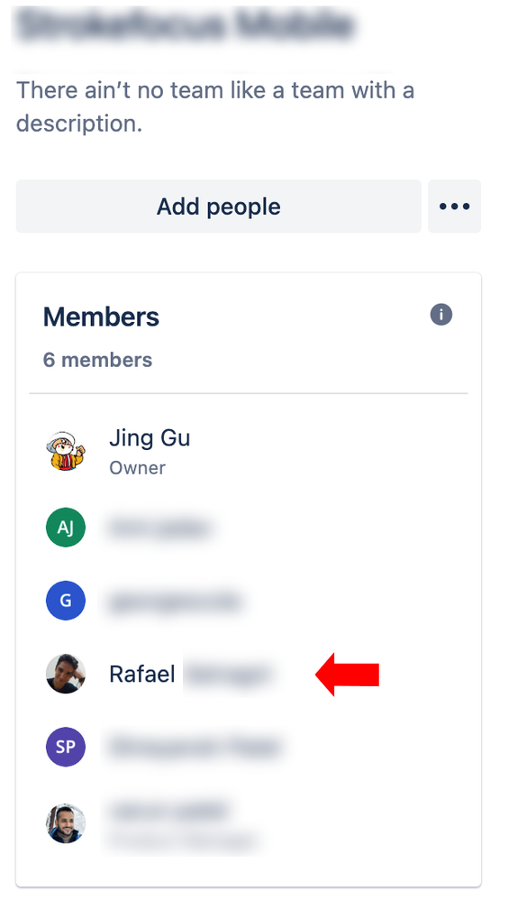

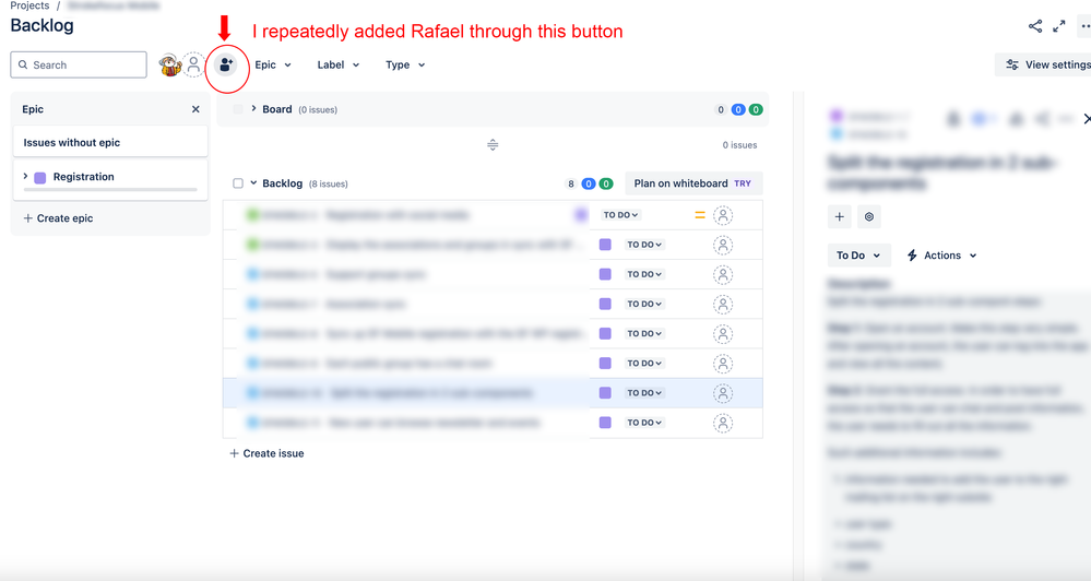

I have created a backlog board for our project, and invited key developers to join the board.

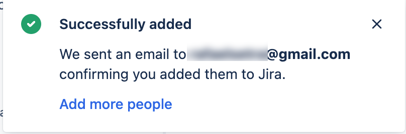

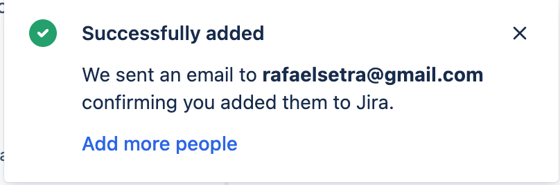

And I receive confirmation from Jira, like this:
And I also see them on my team list. Like this:

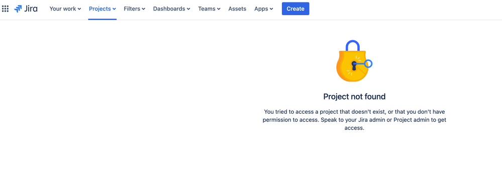

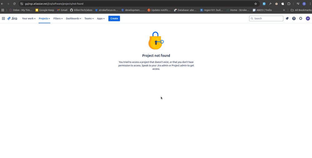

But none of them have access. They try to open the link to the backlog board and sees this
This has put our project to a grinding half. We have a tight timeline.
Please help.

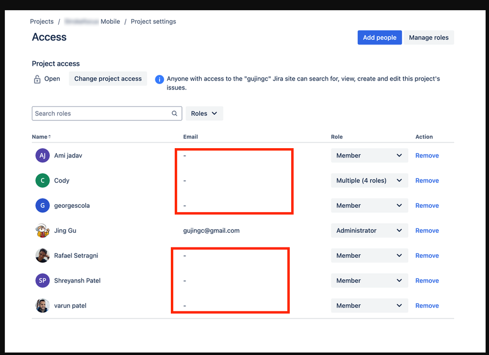

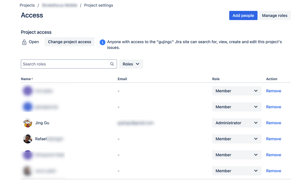

This is how I granted project access in the Project Setting.
You can see they are all on it.

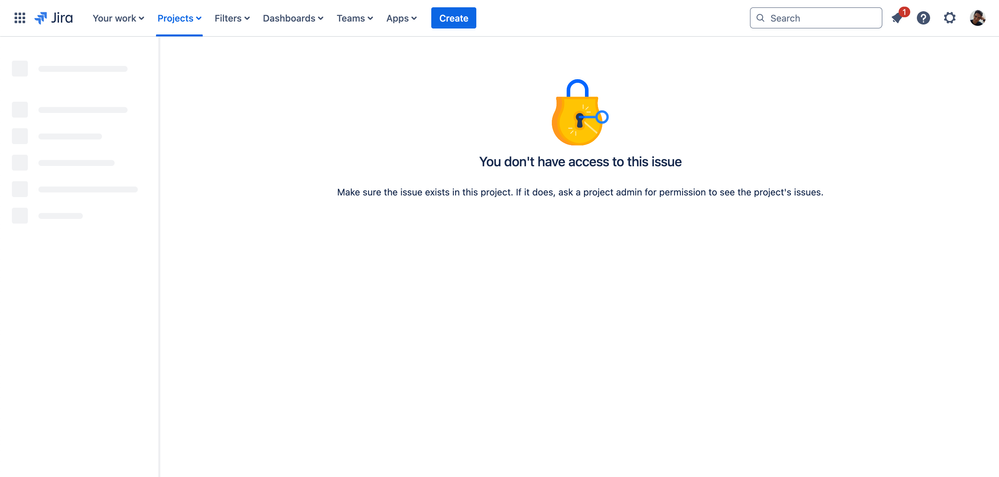

Other team members on this list are seeing exactly the same thing.
Below is the the screenshot of another user on the list.
Is this a bug?

And with that screen image showing "Access" at the top, I can tell you are working with a Team Managed project.

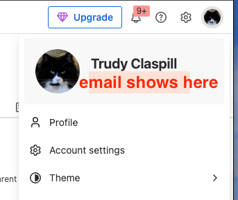

Typically the Email column in the above screen will show the email for the user, but in your image it shows dashes. Did you modify the image or are dashes actually shown in the screen?
Have you confirmed that Rafael is logging in to Atlassian Cloud with the same email that you used to invite them? They can click on their avatar in the upper right corner to confirm the email of their logged in account.

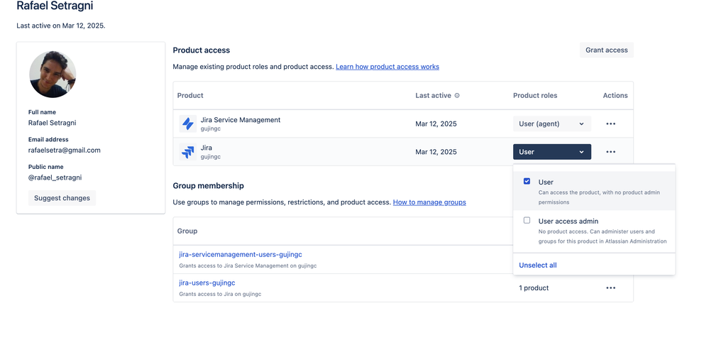

I do not know how to get the profile display like you illustrated above. But see below.
And this confirmation I received from Jira prior to his access, I have to think he is logging in using the same email as invited.
I received this confirmation immediately after sending invitation to Rafael.

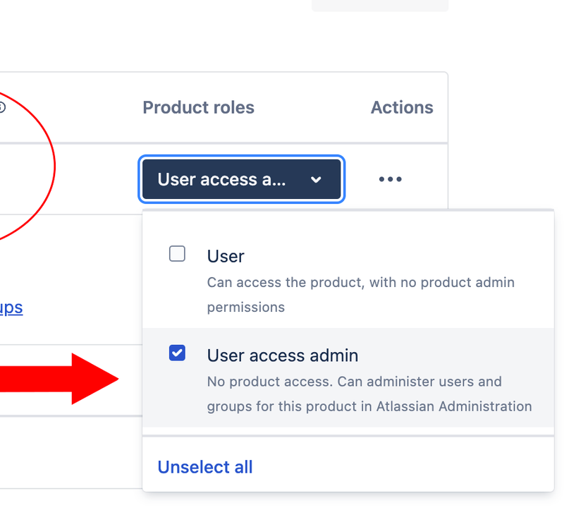

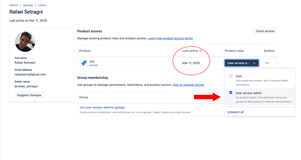

Looking at the user account information you displayed, this is the problem.
By checking that box you have given the user access to manage the access of other users. Notice that check box says in the description "No product access". That checkbox by itself does give the user proper access to the Jira product.
To give the user proper general access to Jira as a normal user you need to check the other box for the User product role. Checking that other box should solve the issue.
You may also want to uncheck the User Access Admin box. With that box checked the user will have access to User Management and be able to add and remove other users for your Jira instance.

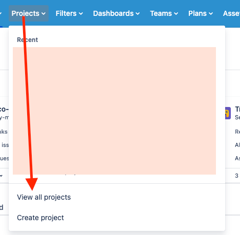

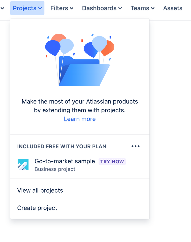

While logged in as that user if you pull down the Projects menu and select View All Projects, do you get a page that lists the project the user needs to access?
Assuming that the specified project is in the list, what happens when the user clicks on it?

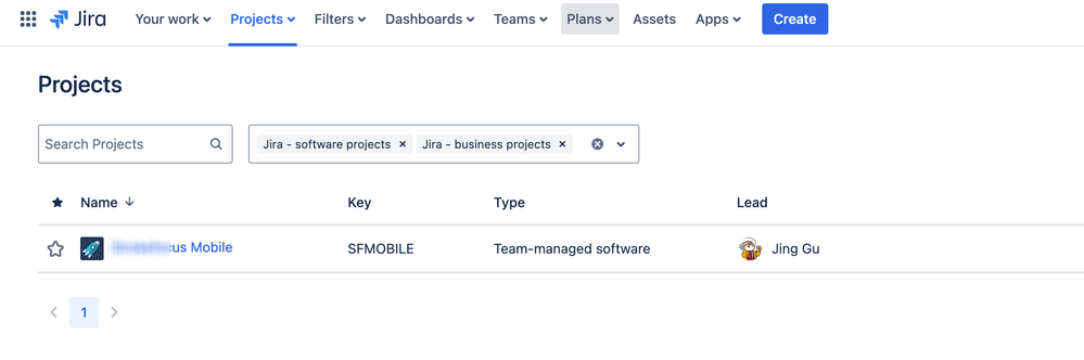

Jing Gu
March 12, 2025
Trudy, I tried.
When I log in as myself, I see my project.
But when I log in as the developer, then the project can not be seen, even trying to click on the link of the backlog board.
This is the same to every other user.

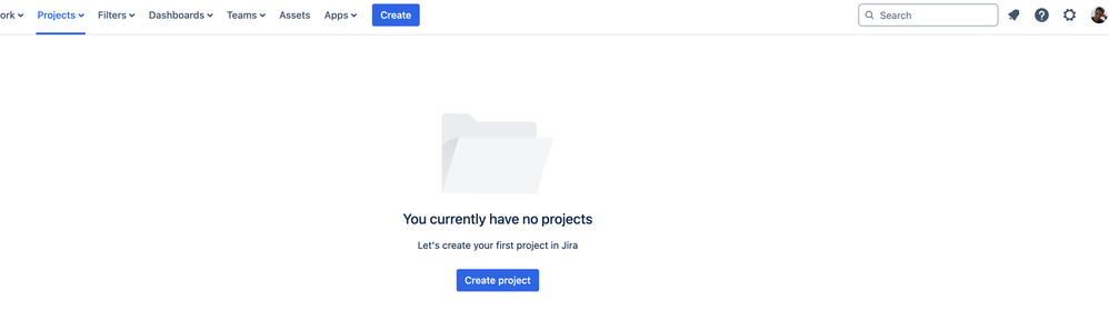

Trudy,
I just checked. No project shows under him.

Are you saying that when you are logged in as the other user and you go to the View All Projects page, no projects are listed?
The change may take a short amount of time to take affect.

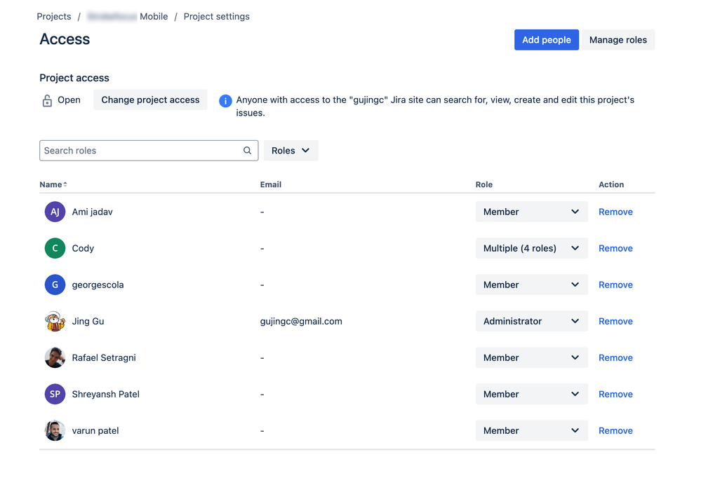

project access setup.pngThis is how I set up my team access. He clearly should have access.
Maybe the conclusion is this platform is so badly designed, this very basic function is simply impossible.
He and his entire team is flabbergast that team access is so hard or frankly impossible to solve. Their confidence in Jira totally collapsed.

Jing Gu
March 12, 2025
Trudy, correct.
When I click on All Projects under him when logged in as him, NOTHING shows.

Trudy P Claspill
March 12, 2025
I am sorry you are having a frustrating experience.
From the information we have exchanged it seems like you have set things up correctly.
The only odd thing I can see in the information that you provided is that there is no email address showing for the users in the Access page.
I have not seen that happen before, so I'm not sure how to diagnose that problem. I am reaching out to other Community Leaders to see if they have additional suggestions.
