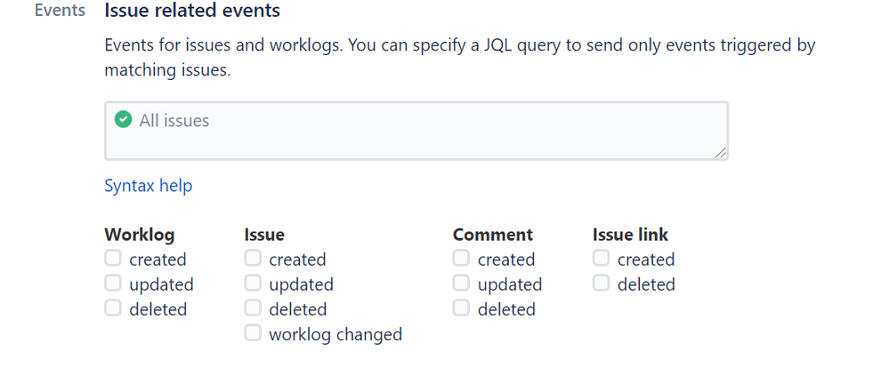

I have created jira webhook, but I couldn't see Attachments events check boxes .
Could you please help me to get that.
PFB screenshot :
Please help me with this..

Hi,
There is no attachment event, but if you add/remove attachment it should trigger the issue updated event.
Did you try issue updated ?
sriharsha m
August 10, 2021
@Mohamed Benziane  ,
Thanks a lot Mohamed.
We are trying using Integration Hub. From Jira -> Servicenow.
We have tried with Issue updated event for attachments sync. But whenever issue has been updated, automatically attachments are being added in Servicenow (  Duplicating attachments everytime).
