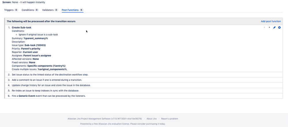

We have opened a Support Request SUPPORT-2510 for this issue and request you to please sign in to the portal and provide the email id so that we can add you as the participant for SUPPORT-2510. You will receive further updates in the SUPPORT-2510 ticket.
Please note that you will not be able to create "x" number of sub-tasks based on numeric field, but will be able to create sub-tasks based on the list of values. For example, if you have a component field with the values X, Y, Z then we will be able to use the create on transition post-function to create sub-tasks for each component. Please see the below screenshot for reference.
Note: In the above screenshot the original_components (gets the list of components in the parent issue) and %entry% on the components field will supply each value to be set to the sub-task
Also please see the page Create multiple issues for reference.
