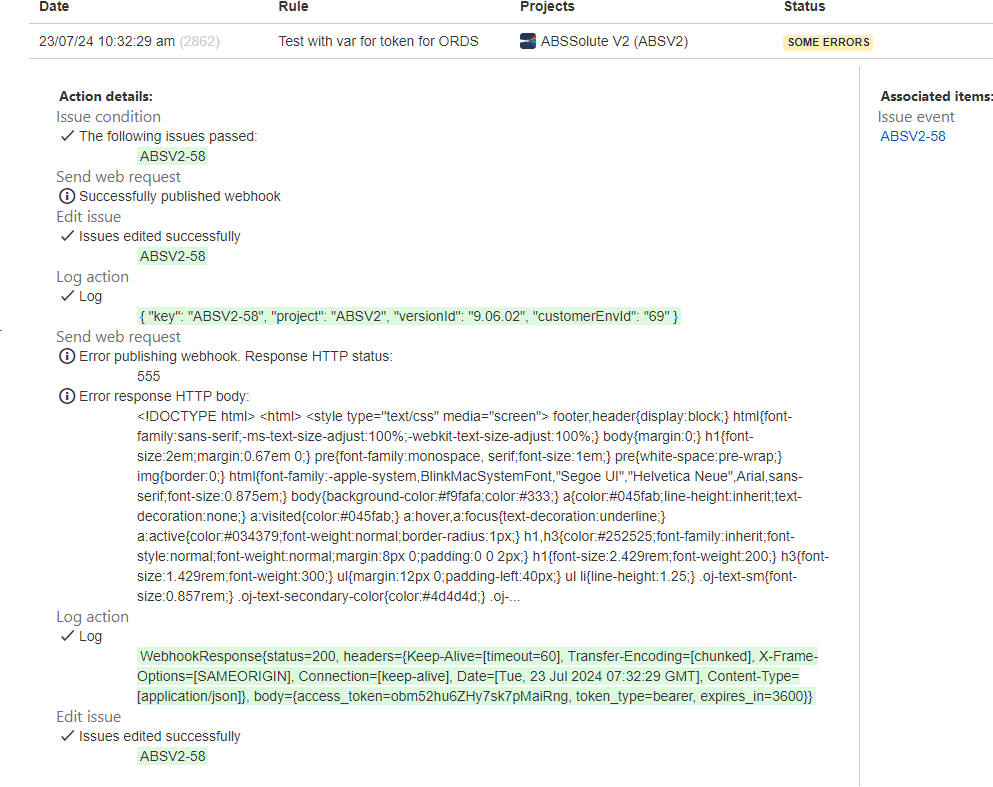

I'm trying to create an automation rule to get some data from one of ours servers. I managed to have a happy path - when all connections work... But from time to time "something happens" and I get an error (and I nee to have a different behavior for it).
I see in the audit log the error, but I can't get the data in webhookResponse. WebhookResponse has the values from the last (successful) call

Thank you for your reply. This are exactly the steps that I have followed, but I can't get to capture the error message.
I have 2 requests in my automation, one to get a token and then to request I'm interested in.
If you look in the picture, you see I actually get a 555 for my second request, but my response is 200 (from the first).
I've set the second call to wait for the response, and in this situation it 'freezes' there, no logging for second call.
Do you have any recommendations?

I get the same behaviour.  I can capture the value of {{webhookResponse}} when the automation returns 200, but if it doesn't the automation errors out on the webook.
I.E.: the automation terminates immediately when there is an error, so nothing further can be logged, nor can any conditional logic be applied to result.
This looks like a bug.  Does anyone have a solution?
