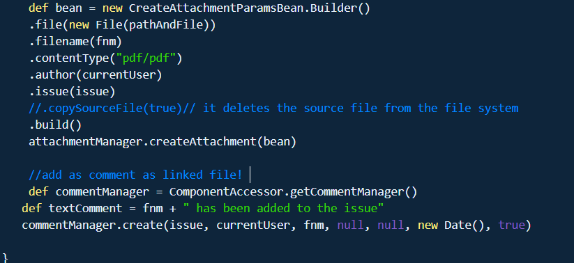

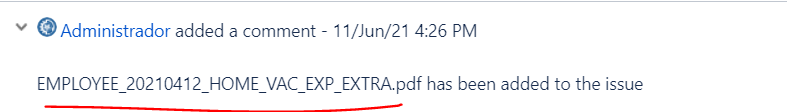

hello,
i want to attach pdf attachment(link) in comment using
def commentManager = ComponentAccessor.getCommentManager()
def textComment = fnm + " has been added to the issue"
commentManager.create(issue, currentUser, textComment, null, null, new Date(), true)
above code create comment as "text" not " pdf link",like below

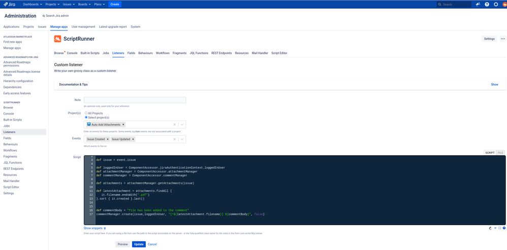

For your requirement, I assume you are using a Listener to trigger the comment update.
You could try something like this:-
import com.atlassian.jira.component.ComponentAccessor
def issue = event.issue
def loggedInUser = ComponentAccessor.jiraAuthenticationContext.loggedInUser
def attachmentManager = ComponentAccessor.attachmentManager
def commentManager = ComponentAccessor.commentManager
def attachments = attachmentManager.getAttachments(issue)
def latestAttachment = attachments.findAll {
it.filename.endsWith(".pdf")
}.sort { it.created }.last()
def commentBody = "file has been added to the comment"

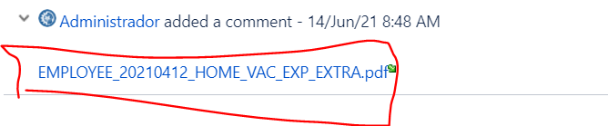

commentManager.create(issue,loggedInUser, "[^${latestAttachment.filename}] ${commentBody}", false)
Please note, this sample code is not 100% exact to your environment. Hence, you will need to make the required modifications.
Below is a print screen of the listener configuration:-

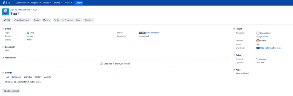

1) First, when the issue is created, no attachments are added, as shown below.

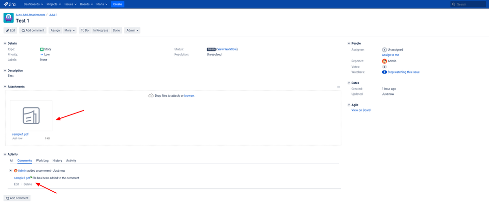

2) Once an attachment is added, refresh the page, and you will see the comment is automatically added, as shown below.

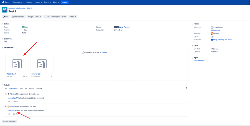

3) Adding other pdf attachments, and the comment is updated as well as shown below:-
I hope this helps to solve your question. :)

Sneha Gole
June 14, 2021
thank you so much for your effort   @Ram Kumar Aravindakshan _Adaptavist_  it work like wonders !!!!
