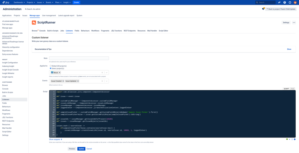

Below is a print screen of the Listener configuration:-

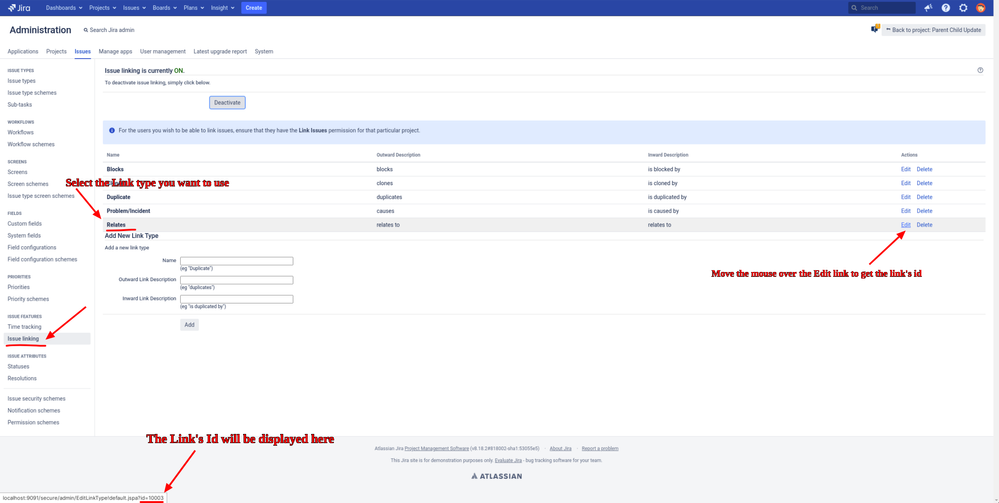

To determine what type of Link you want to use, you will need to visit the Issue Linking page as shown below:-
Once you have decided which link type you wish to use, you will need to move your mouse over the Edit link.
You will then see the Issue Link's ID. this is the ID you will need to use in this line of code:-
issueLinkManager.createIssueLink(issue.id, sourceIssue.id, 10003, 1, loggedInUser)

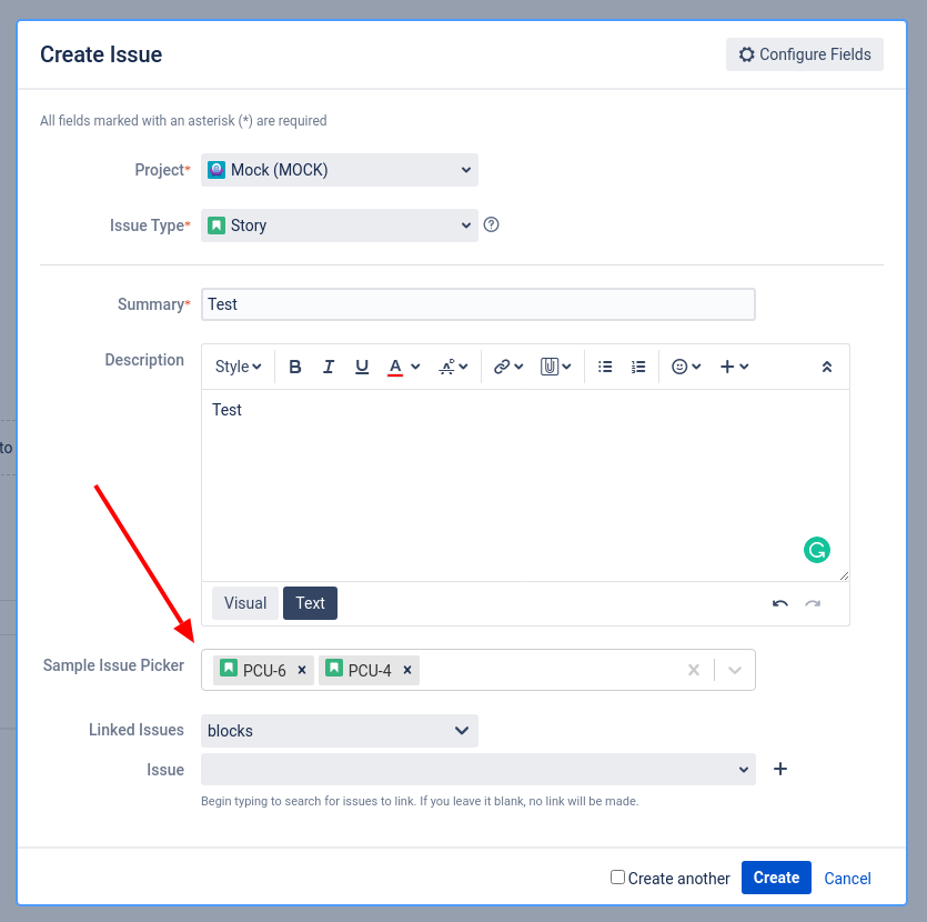

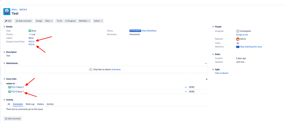

Below are few test print screens:-

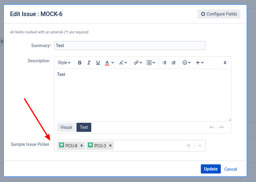

1) When the issue is being created, two linked issues are added as shown below:-

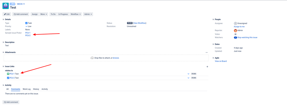

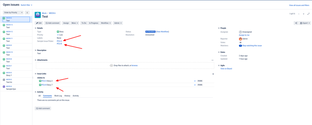

2) Once the issue is created, the Issue Link is automatically created as shown below:-

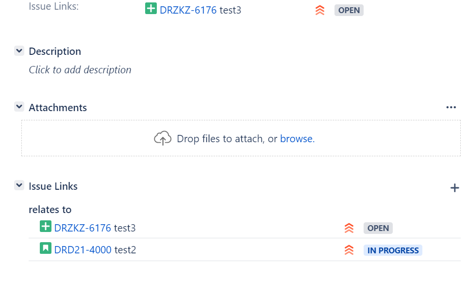

3) Similarly, if an issue has already been created, and the links are included as shown below:-
test3.png The issue link will also be created as shown below:-

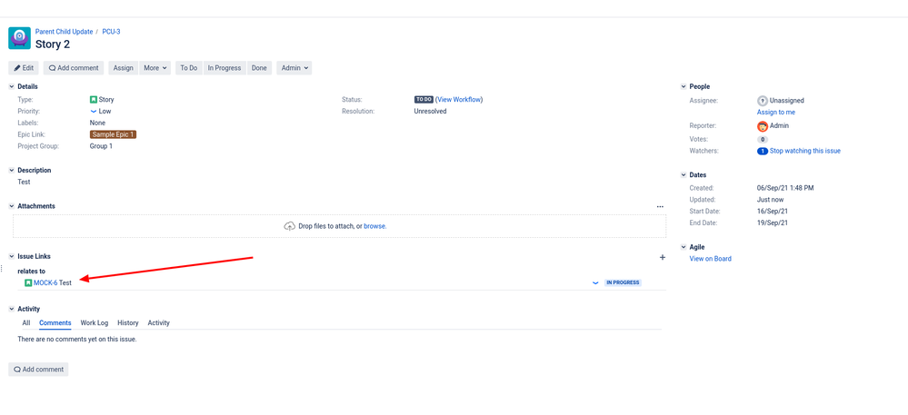

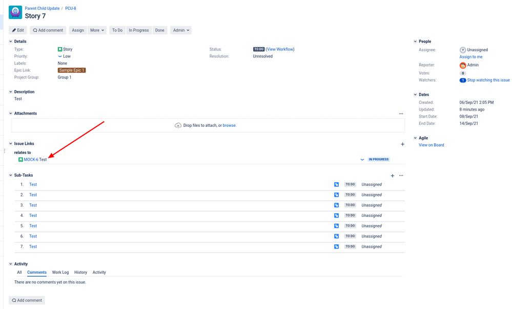

But the thing is I want linking should be done from both the sides like as MOCK-6 is showing PCU-8 and PCU-3 in Issue Links same should be done from PSU-6 side need to show MOCK-6 in Issue Links

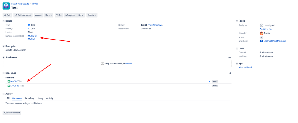

Hi @RSP ,
When a link is created from one issue to another, the issues involved in the link will automatically have the link.
When the link was created in MOCK-6 to PCU-3 and PCU-8, the link was created in MOCK-6 as well as in PCU-3 and PCU-8.
There is no need to do an additional linking config.
Below are the print screens for your reference:-

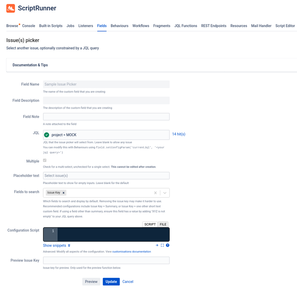

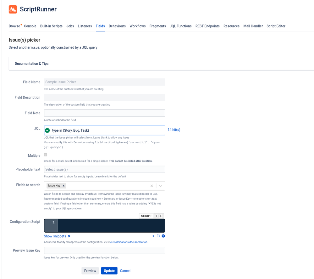

First, change the JQL Query in the Issue Picker to something that is not Project-specific  (i.e. if you want it to contain issues from all projects) for example:-
type in (Story,Bug,Task)
also, as shown in the print screen below:-

As mentioned in my previous comment, did you ensure that you have updated the Issue Picker's JQL Query and remove the option of which project you want it to work on, and instead specify what issue types you want it to work on, i.e. for example from:-
project = MOCK
to
type in (Bug, Story, Task)

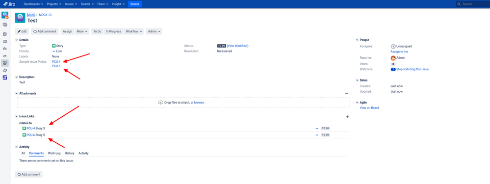

Below is a print screen of some test cases on different projects:-

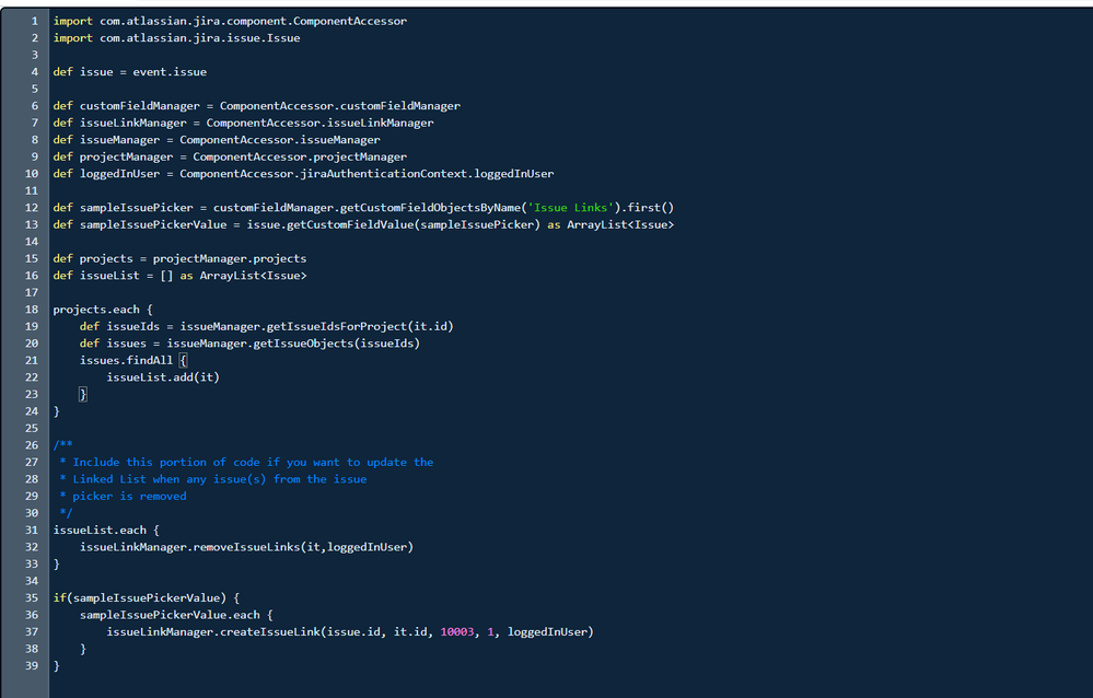

RSP
September 21, 2021
Hi Ram,

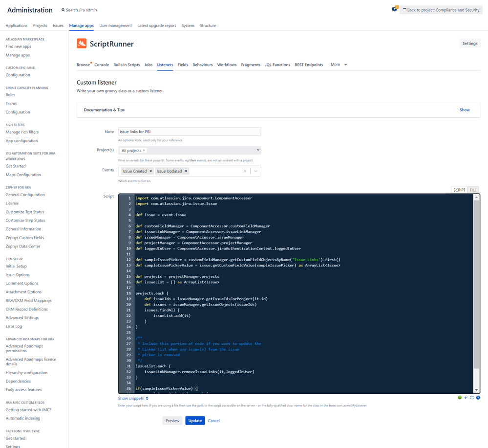

I have added the same listener code just changed the field name as "Issue Links".
Still issue not get linked. Before it was working for single project.
Please find the attachments.
Please check and let me know.

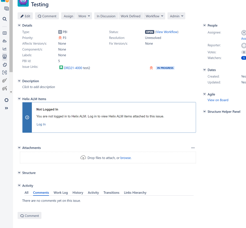

I have removed the issue from field. but it still showing in issue links[ relates to].

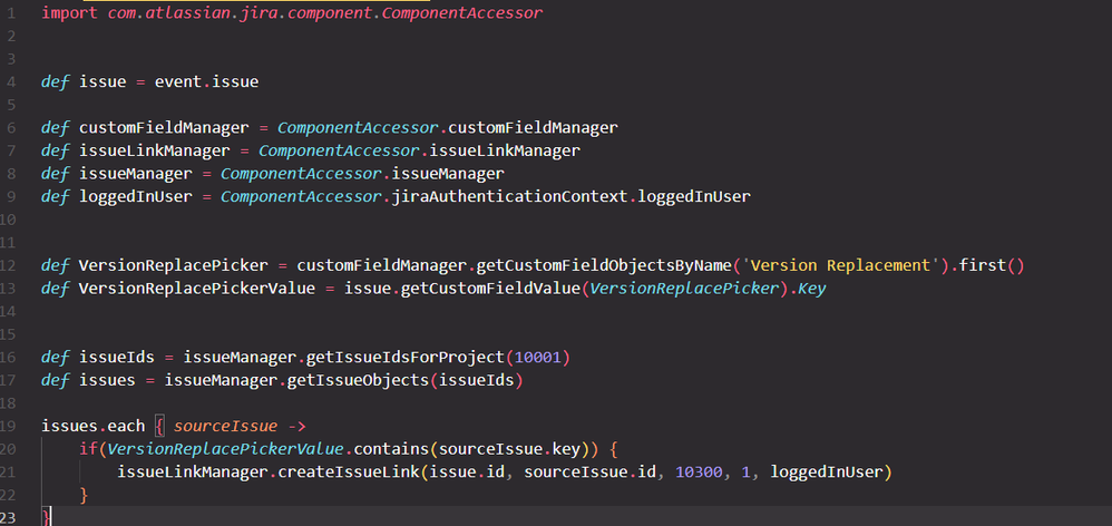

@Ram Kumar Aravindakshan _Adaptavist_
I am doing these steps for a single project. It is working great! However, when I select my sample picker value of Media-80 it links both 80 and 8! Any ideas?
import com.atlassian.jira.component.ComponentAccessor
def issue = event.issue
def customFieldManager = ComponentAccessor.customFieldManager
def issueLinkManager = ComponentAccessor.issueLinkManager
def issueManager = ComponentAccessor.issueManager
def loggedInUser = ComponentAccessor.jiraAuthenticationContext.loggedInUser
def VersionReplacment = customFieldManager.getCustomFieldObjectsByName('Version Replacement').first()
def VersionReplacementPickerValue = issue.getCustomFieldValue(VersionReplacment).toString()
def issueIds = issueManager.getIssueIdsForProject(10001)
def issues = issueManager.getIssueObjects(issueIds)
issues.each { sourceIssue ->
    if(VersionReplacementPickerValue.contains(sourceIssue.key)) {
        issueLinkManager.createIssueLink(issue.id, sourceIssue.id, 10300, 1, loggedInUser)

Aaron Coonce
January 12, 2023
Ram,
I appreciate your assistance I actually got it to work! I took your formula and adjusted it a little! Thanks for solid explanations!
