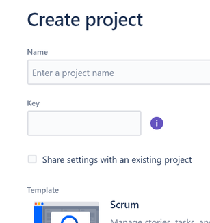

Esther Strom
June 16, 2020
The project name can be the same; what you can't reuse is the project key.
So for example, when you created the original Engineering project, Jira assigned a key, probably something like ENG. If you create a new project and name it Engineering, as long as you change the key to something else (like ENGI, or NG) it should let you create the project.
I just tested this with an old demo project I had set up and it did allow me to use the same name.

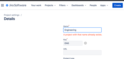

Leah
June 17, 2020
thanks @Esther Strom
unfortunately i am still seeing an error message when i try to use the same name. I do think i found a (not great) way around it though. If I add a space at the end of 'Engineering' I am able to use it.
I also finally found the 'trash' but restoring it didn't work...

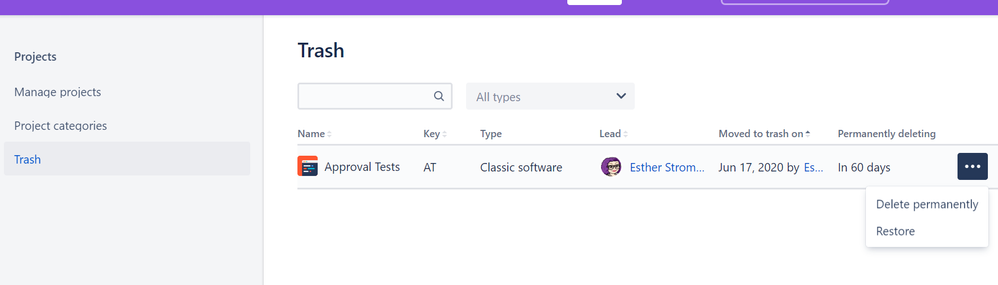

Esther Strom
June 17, 2020
OK, if your original project is still in the trash, that might be what's causing it. Can you go to the trash and completely delete it?
