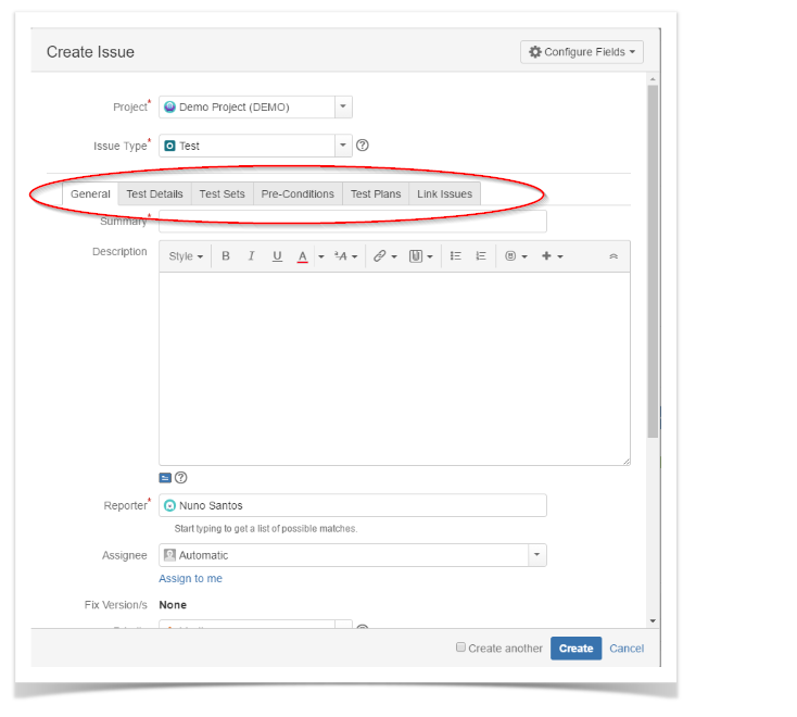

Thanks... but on my view I don't have the part the test steps...
I just see issue type, summary and description...
what do I need to add to see the marked in the print screen section?
Hi ,
Did you read the link to customer fields and screens?
You will have to enable that field in your field configuration and add it to your screen.
