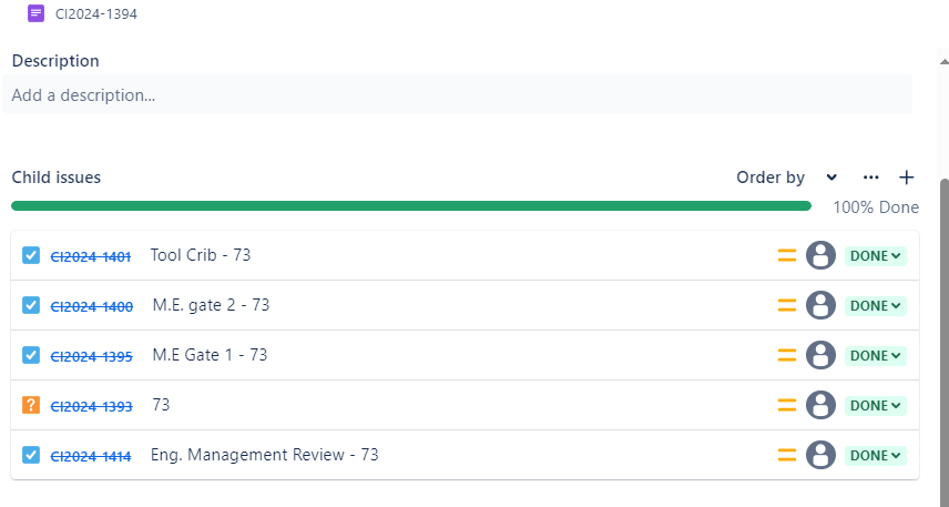

There is a total of 4 children
  • Me gate one (part eval)
  • Tooling
  • ME Gate 2
  • Review

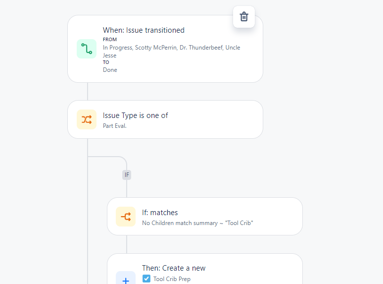

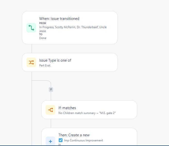

to create Tooling and ME Gate 2: Part Eval is transitioned from in progress to done.
Both ME gate 2 and Tooling share the same Custome issue field, which is a part number, however, all the children share this Custome field.

I see that one of these issues is issue type "Tool Crib Prep" and the other is "Imp Continuous Improvement". Will this be the only pair of issues under the Epic that use those issue types? If so, that could be used as the identifier in the rule.
If they are not the only issues of those types under the Epic, then will this pair of issues always use the Summary values of "M.E. gate 2" and "Tool Crib"? And will they be the only issues in the Epic that use those exact Summary values? That could be another way to identify the pair of issues.
Lex Baldridge
June 6, 2024
 These are all of the issue types, also when I was attempting to do the summary equals "" it would throw errors. The summary values for all of them are the name then the custome fieldCapture 3.PNG
