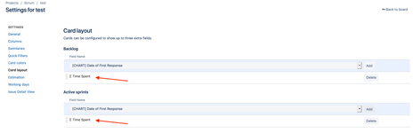

Indeed, the default estimation field usually displays the time spent in the parent issue itself, however, you can customize your board cards with the "Σ Time Spent" field, that displays the sum related to the sub-task issues. These would be the steps:
  1. Navigate to your board > ... > Board settings > Card layout
  2. Add the "Σ Time Spent" field to your card layout:
  3. Additional to that, you can use the fields "Σ Original Estimate" and "Σ remaining Estimate" to display more information related to time tracking.
