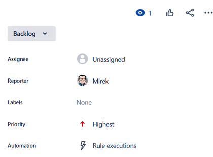

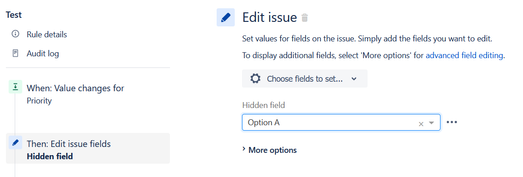

I have a simple rule created in Automation to set value of a "Hidden Field" to Option A (there is also Option B available)..

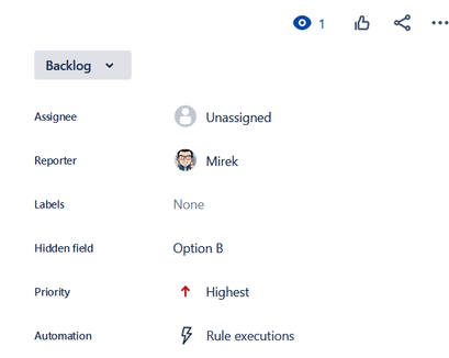

So I created an issue and had my field on the screen to show that is having a value set to Option B (and Priority Highest)
Then I remove Hidden Field from all screens so it is actually hidden in the UI ...

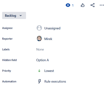

Changing the priority to Lowest and showing (adding back) the field on the screen again later gives me this result..
So it looks like it is working. Value is changed in the background no matter if we see the field on the screen (Create/View/Edit) .
