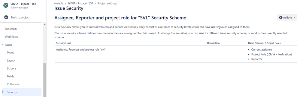

Yes, is what I do. I put the group in Browse Projects (I don't know if is the good thing because it's write project and issues "Ability to browse projects and the issues within them.") and I create a security :
with the current assigned, the reporter and another group, they can see all.

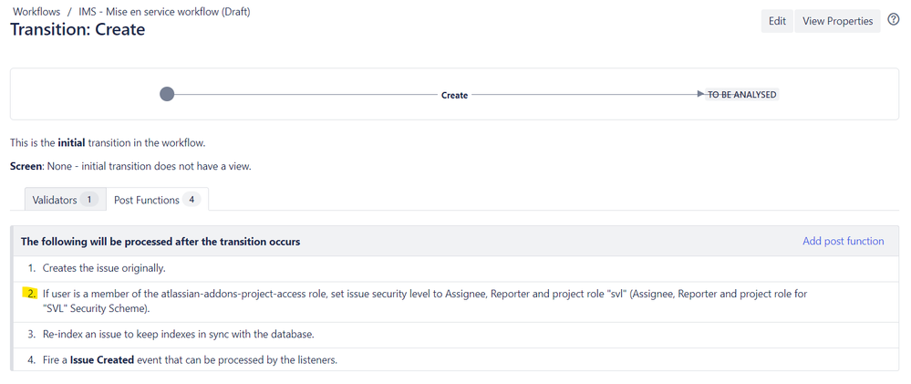

I call this security in my workflow on the transition Create.
But my group see all issues,

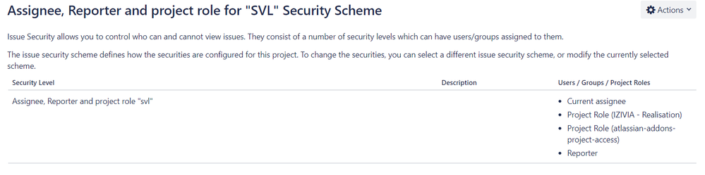

Additionally, as I said, do not use the atlassian-addons-project-access role. Users should not be assigned to that role. Create a different project role for this group of users.
Hello,
Oh yes sorry, it was a mistake of inattention.
For me, I followed all your recommendations but it still does not work as I want.
On the workflow at the transition create :

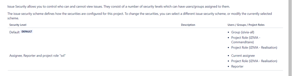

Finally, by adding a security level by default because I thought that maybe, I had misunderstood your last point, it works a little better.
I just have the problem that my SVL group doesn’t see anything even if it's create the issue, and it's reporter on the issue

1. Now, I have 2 security level. one for Joe and Sally and one for Bob this is the default (I put all the people we can see).
2 and 3. For me, it's in the workflow with my issues I say in the create transition, the level security for "IZIVIA - SVL" is Reporter, IZIVIA-Realisation and Current assignee

2. Can you show use the workflow details where you are setting the Security Level?
