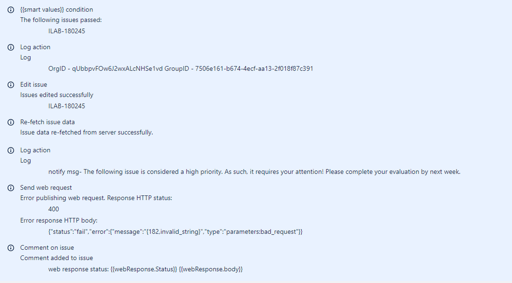

I have a string in a multiline field (as seen above) and I want to send it via webservice.
I found out that I could not send multiline in webservice so I created a new simple text field with the same text and I sent it via the webservice but I got an invalid string error all the time.
When I set explicitly the message with the new line chars in the Jason body, it can send it through.
The automation:Trigger.PNG
The audit log:auditlog.PNG
Bill Sheboy
March 11, 2024
Thanks for that information, David.
Rather than moving the data to another custom field, have you tried using one of the encoding functions on the original multi-line field and then sending that in the message?  That should preserve the characters using the relevant protocol.
https://support.atlassian.com/cloud-automation/docs/jira-smart-values-text-fields/#Encoding
david_levy
March 12, 2024
Thanks, Bill,
I tried the {{issue.summary.jsonEncode}} and it works as you suggested.
Thanks
