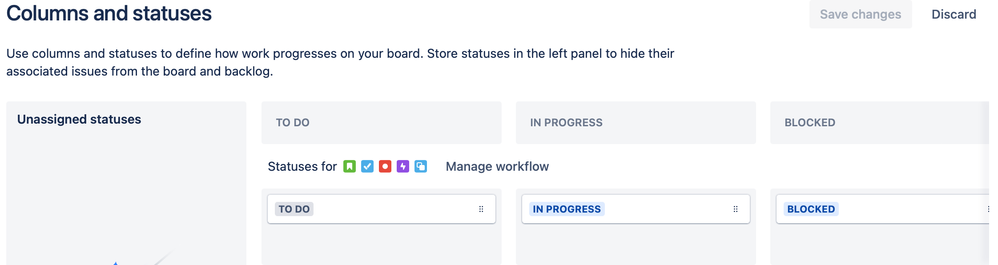

Those are not statuses on the sprint board, they are GROUPS of statuses (go into the board settings to see what statuses are actually there in the columns tab).
You can then use various gadgets and reports to show you the workload in a sprint.  I don't know which version of server or what add-ons you have, so I can't be more specific.

After going into the board settings, it seems like there is a status for each column. (when scrolling to the right, it shows each columns with review, validate, and done after blocked in screen shot below)
