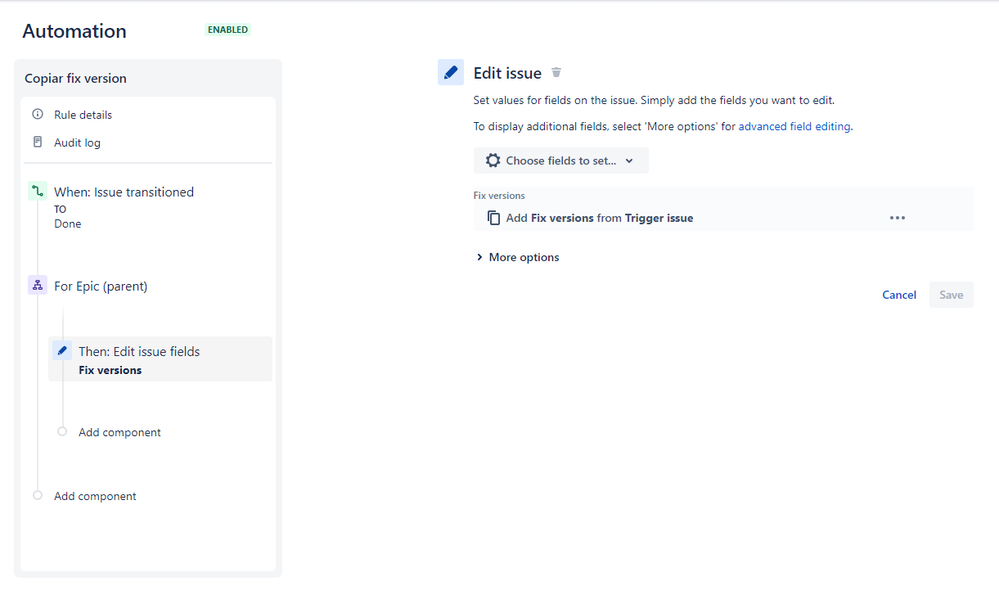

Ander February 28, 2023
Thanks @Jack Brickey
I started with this, but does not work

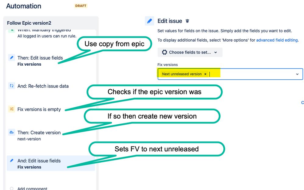

@Ander , here is an example rule below. However some things that need pointing out.
  • You may already realize this, release versions are unique to a project. I mention this only because you indicated you have a project for Epics and then another project for the actual issues. So unless you are manually keeping Release version names in sync across these two projects then you're going to run into issues.
  • The way I approached the problem in the rules below what is as follows:
    1. When an issue is moved to done
    2. Copy the value of the FV in the triggering issue's Parent epic into the triggering issue's FV field
    3. Check to see if the triggering issue's FV field is empty. If not the rule will exit. If so continue...
    4. Create a new release version
    5. Edit the trigger issue and set the FV field to the latest unreleased version. This obviously assumes that all previous versions have been released and the previously created release equates to the latest unreleased version. This could be a bad assumption for sure. So you need to work out the specifics of how your releases are managed.
