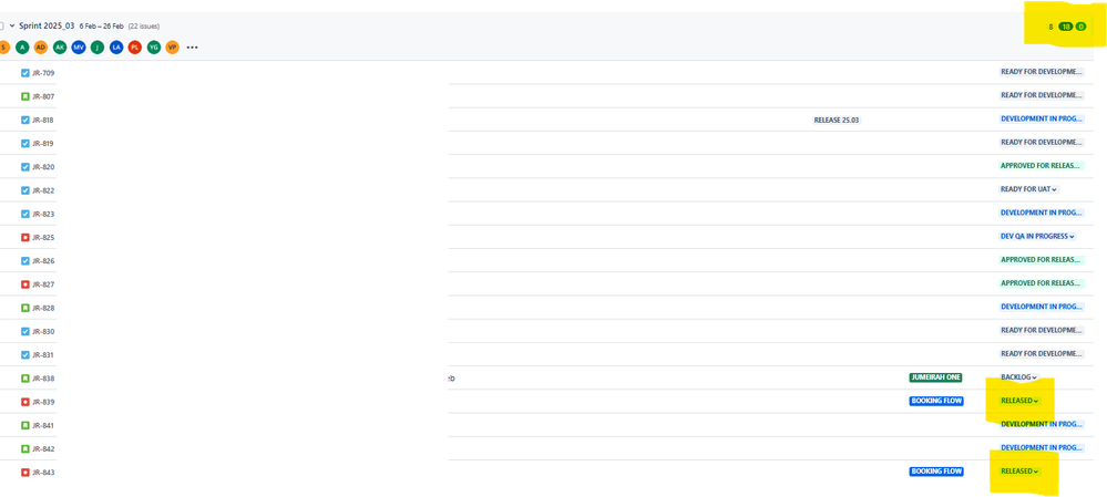

Hi everyone, I have worked on the suggestion @Bill Sheboy  did , and moved Done column to last now this is how my board looksScreenshot 2025-02-14 092250.png
but I have noticed the tasks in my sprint still doesn't shows as story points completed however I have 2 tasks completed and has 3 story points (please see screenshot below)
2 yellow highlighted are in done status but still shows as 0 completed story points.
is that because JIRA  will consider any changes before moving the column DONE to the end ??
Bill Sheboy
February 13, 2025
Hi @Fatima AlZarooni -- Welcome to the Atlassian Community!
For Jira's Scrum boards, an issue is considered completed for the sprint when it is in a status mapped to the last / rightmost column of the board.  The resolution, status category, etc. have no impact.
If your "done" status is not mapped to the last / rightmost column, that is why Jira indicates the issues are not done when you try to complete the sprint.
