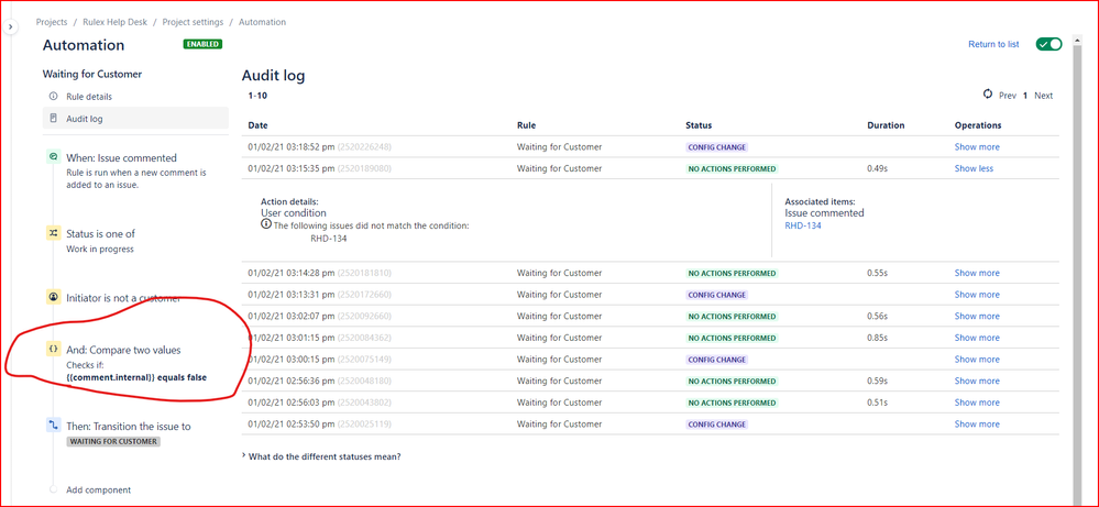

Team...I'm trying to write a rule that will trigger a status change if a agent asks the customer for additional information or a question. This does not seem to work...any suggestions

Now back to your request there is rule in the library that is a good starting point and that my be where you went for ideas (When a comment is added --> update the status). Can you look at the log and see where the rule is escaping?

Thanks for the info Jack...I think I will keep things way they are but investigate and do some testing to see how it feels...considering we are moving to more nex gen projects i can see how it fits. OBTW did you see rule I have already attached...I have circled the area that maybe the issue.

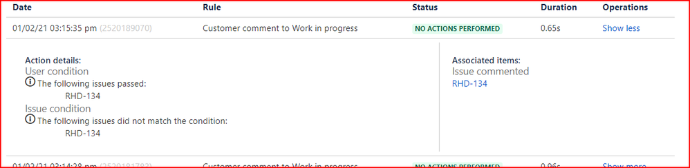

yes saw that but at first blush it looks alright. did the logs indicate that did not pass the condition?
