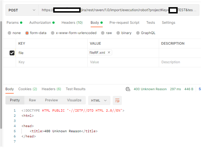

I am trying to call API for robotframework in order to import Xray.
But when I call and send my request, I am getting error as "Your browser sent a request that this server could not understand."
I tried to call API both with Postman and curl (in addition Postman sometimes give 500 Internal server error)
POST Method and using form-data ( upload output.xml) (You can see screenshot)
URL : https://xxxxxx/jira/rest/raven/1.0/import/execution/robot?projectKey=TEST&testExecKey=TEST-394
and The curl;
curl -D- -u user:psw -X POST "https://xxxxx/jira/rest/raven/1.0/import/execution/robot?projectKey=TEST&testExecKey=TEST-208" -H "Content-Type:multipart/form-data" -F "file=@output.xml"

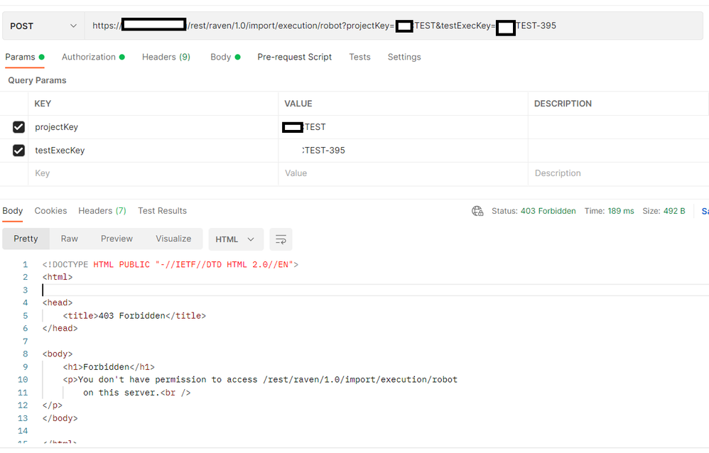

Thank you for your reply, but also I tried this url on POSTMAN. In that case, I am getting another error.
<head>
    <title>403 Forbidden</title>
</head>
<body>
    <h1>Forbidden</h1>
    <p>You don't have permission to access /rest/raven/1.0/import/execution/robot
        on this server.<br />
