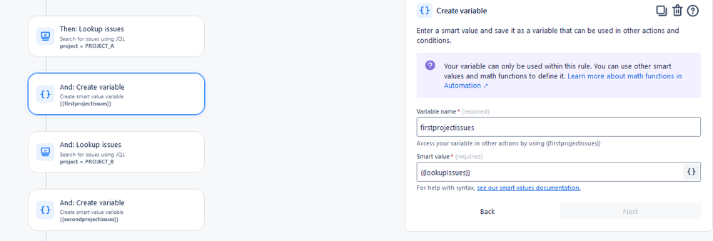

Michael Wohlgemuth
April 25, 2024
Perhaps you could use 2 lookups (one for each project) and store the results in a variable?
Never tried, so not sure, but it might work. Would roughly look like the following:

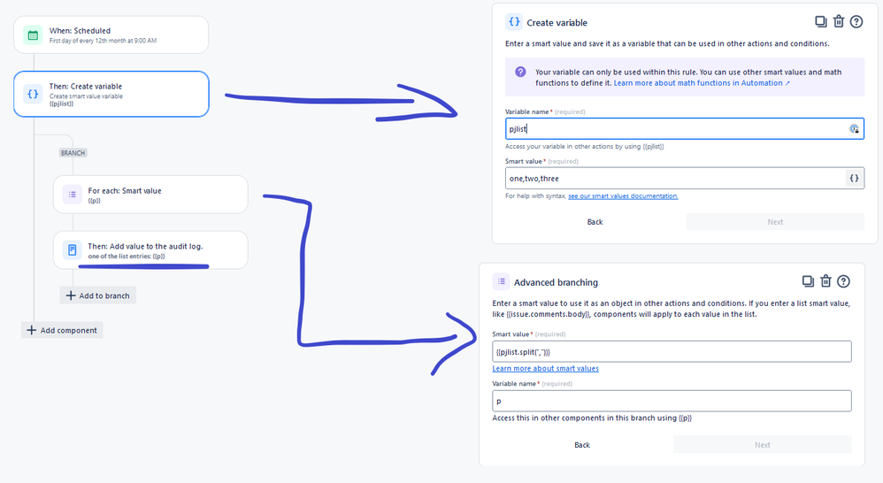

Michael Wohlgemuth
April 26, 2024
Depending on your automation version you could probably create a list at the start of the automation and then go through each entry in that list (say, of projectkeys) via the smart value branch.
Result is:
Which means, you can probably then use the JQL described earlier, but replace the project keys with {{p}} within the branch. Perhaps. Again, untested, all.
