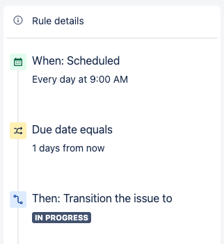

Hi @Ivan Andrieiev ,
I recommend a scheduled automation rule that checks for Due Date. See screenshot for an example.
Regards,
Marco Brundel

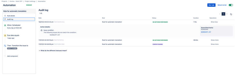

Ivan Andrieiev
July 18, 2023
 @Marco Brundel  Hi
Why it doesn't work?
Marco Brundel
July 18, 2023
There is not enough information to determine why it does not work.
Among other things: What is the due date of the issue? And is Back to Work a status that occurs in the workflow of the relevant issue.
regards, Marco

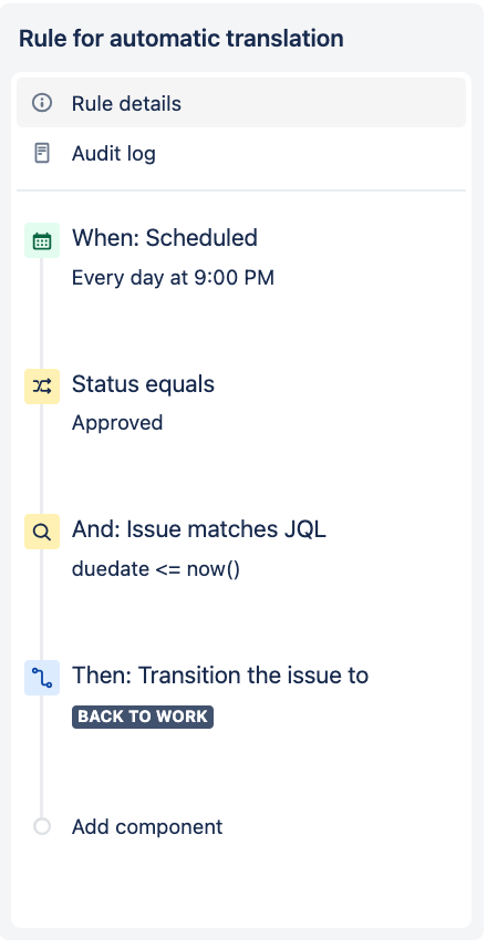

Ivan Andrieiev
September 15, 2023
this is my automation but it doesn't work with additional conditionsСнимок экрана 2023-09-15 в 19.45.08.png
