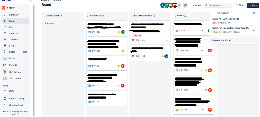

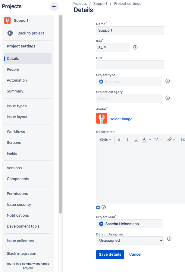

I created a company managed project (in which I merged 3.5k exisiting issues from other projects) with no specific category (none) as we manage a lot of different issue types in this project.
After creation of the project, I added two workflows (one "general" for seven of the eight types, and one specific one for a "special" case).
I have to mention that our initial status has a special name, which is why I changed that.
I was under the impression that the default board reflects the workflow yet whatever I do, the initial state is always empty. Even if I create an issue inside the board. Moving the issue into another status lets it appear. The board does also allow switching the workflows but for both workflows its the same.
Using just the list view is inconvenient as the team is used to the board. Creating a custom board does not work for this project as it appears to only be allowed to software projects and I can not access the board settings whatsowever.
Here is a screenshot (had to blur some parts). Any help or idea how to fix this is highly appreciated.Bildschirmfoto 2022-08-26 um 21.31.11.png

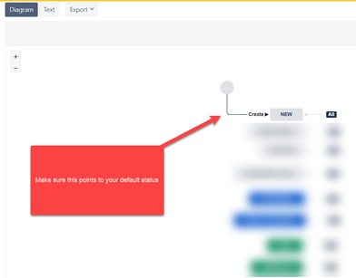

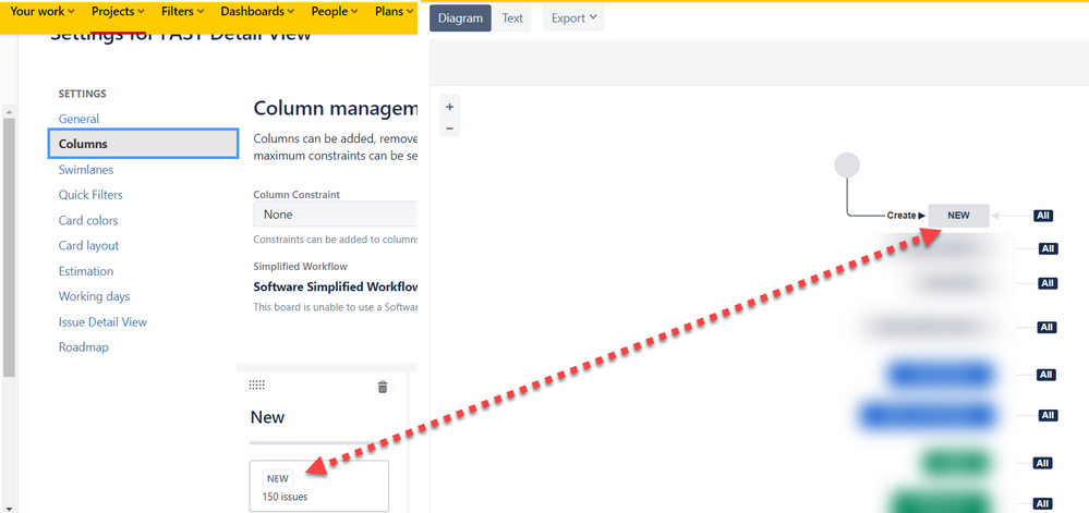

1. Make sure your default status is specified in your workflow (see below). You need to do this for both of your workflows.
2. Be sure in your board settings, the first column has the status that you set for Create (default status) in the workflow step above
Please let me know the status of these.

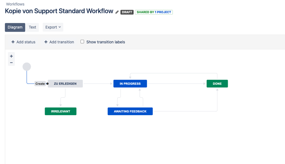

The status is the default one for both workflows and I've also checked properties, validators and post functions to resemble the other workflows in our instance where the expected behaviour actually works.
As for accessing the columns; I think this is where the issue lies. I can't access any settings regarding the board in the project settings page. Also on the board itself I have no access to any properties in the board view.
I suspect that choosing a "blank" project category with no specific type was a bad idea, yet switching to a new project once more is something I'd like to avoid by any means.

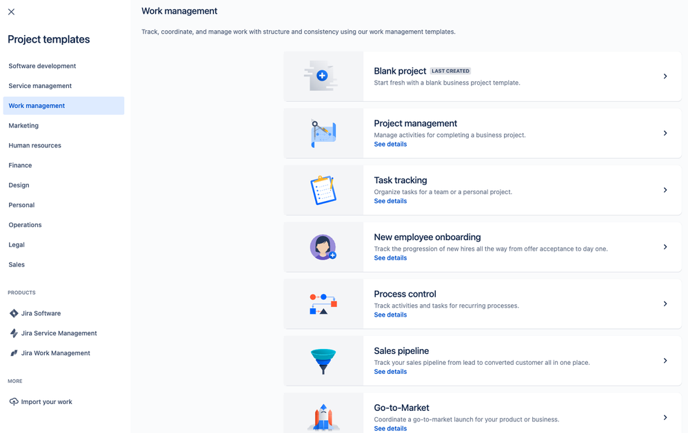

Let's verify something first, please. As @Trudy P Claspill mentioned, you are in a Business Project, and also you used a blank template (these are visible in the screenshot you sent with the project details).
Since you are doing support, and you did not mention other things that might indicate Scrum, it sounds like you want a simple Kanban board where you move stuff across the board from status to status as you work on them, is that right?
If so, then we can make a proper project and move your existing items over to that project. Are you OK with doing that?
If not, just let me know. If yes, then here are the first steps you need to take. Also, I am going to assume you are in Jira Cloud but can you please confirm this?  If you are not sure, look at the URL and if it says ".atlassian.net" anywhere in the URL then you are in cloud.
Lastly, please go to your Create Project screen and take a screenshot.

Dear @Trudy P Claspill & @Michael Simmons  thank you for your reply.
Choosing a Business Project rather than a software project was intended and choosing a "blank" one was probably a bad idea.
The issues created with the "+ Create" button in the "To Do" board get created and they also appear in the list view. As we are not in a Scrum type project but prefer Kanban, the board is a visual indication of the status and yes, we move issues across the board whilst working with them.
Yes! More than just OK with that.
We are in Jira cloud and the URL ends with OurCompanyName.atlassian.net
Here is the screenshot you asked for:

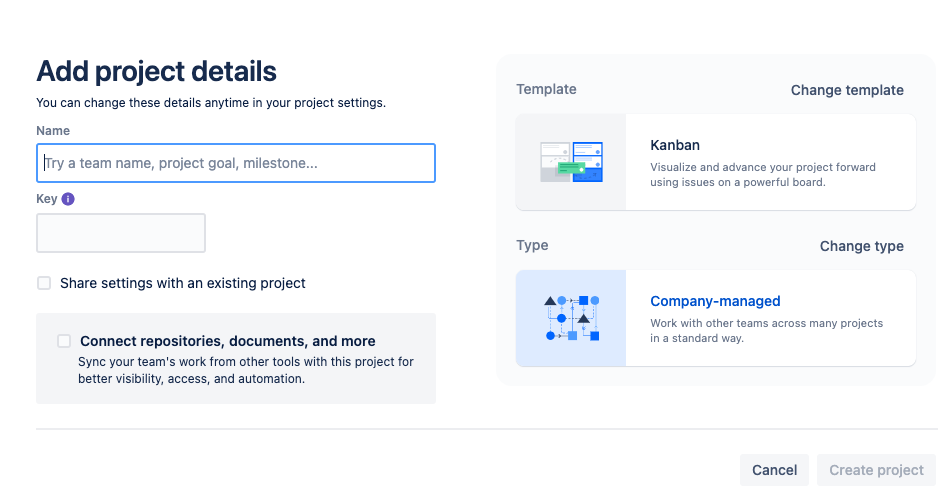

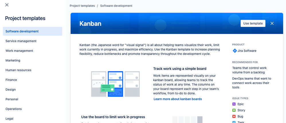

On the left, select Software Development then choose Kanban. This will give you the basic Kanban board you want and the functionality you are looking for. It does not matter what you are tracking (software, business steps, etc.) it will work the way you want.
Then on the next screen, select Company Managed.

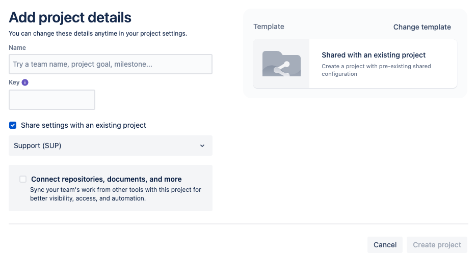

On the next screen, check the "Share settings...." box and choose your current (Support) projects. This lets you reuse flows, etc. and saves you re-work.

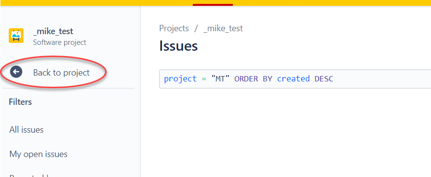

After you create the project, you should see a screen similar to the one below. Just click the Back to Project link.

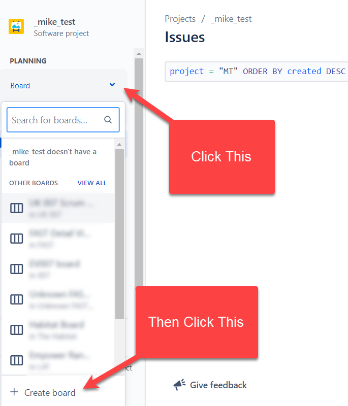

Now create your board by following these steps:
I think you now how to setup the columns and statuses in your new kanban board. If not, let me know.
Go ahead and make a new item and it should fall into the first column. Please let me know.

Hi @Michael Simmons

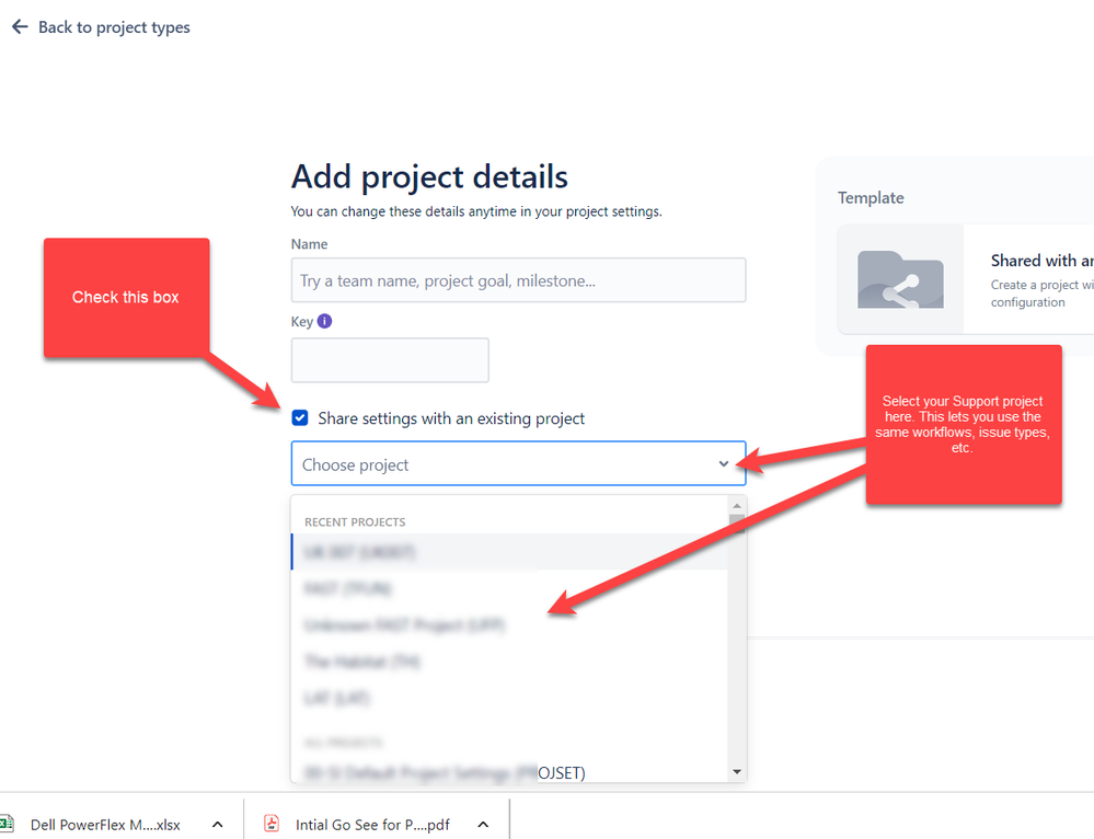

thank you for the detailed explanation and screenshots, yet I think I've come to a point where Atlassian Support needs to take a look into this.
I've followed your detailed explanation step by step yet whenever I tick the box "share settings with an existing project" the newly created project becomes a "Business" type project and the board creation is not available (I've tried four times now, also trying to click on "change template" before creating the project).
I very much appreciate your time and effort @Michael Simmons !
Thanks
Sascha
Bildschirmfoto 2022-08-29 um 20.18.19.pngBildschirmfoto 2022-08-29 um 20.18.38.png
Michael Simmons
August 29, 2022
@Sascha Heinemann
No issues. Simply continue the process but DO NOT click that box. Then we will just manually add the workflows you created to the project.  Keep going, you've got this!

From your screen image it appears to me that you are working with a Business type project, as opposed to a Software type project. I don't work much with Business projects, but it has been my experience that the behavior for those is to have a column for each Status in the workflow, and you don't get the option that @Michael Simmons mentioned about mapping Statuses to Columns.
Was it your intention to create a Business project, or a Software project?
