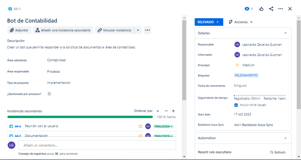

To be more specific. This task belongs to "Project A", I have custom fields "Applicant area", "Responsible area", "Project type" and "Managed by processes?".Campos JIRA Personalizados.png
I have created all of these by configuring the incidents in the project

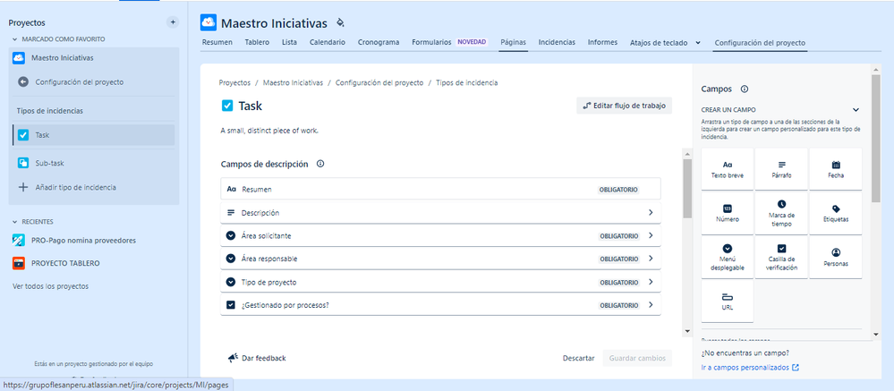

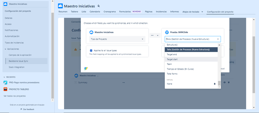

I did this same process for Project A and for Project B. So when linking the incidents in both projects. In Project A the customized ones appear, but in Project B they do not.
And I can't link them. Is the solution still the same or does the context change?

In order to enable custom fields to synchronize with Backbone, you only need to make sure that the fields are present on your edit/view screens as @Margaret Clark described.
When you're then setting up a synchronization with Backbone, you should be able to see the different custom fields and e.g. type in their name to find them.
One thing which comes to my mind is when you've just recently added the field, you can clear Backbone's cache (in the upper right ... menu > Clear Backbone Cache). Backbone then loads all the fields, issue types, etc from Jira again.
Does this help? If not, please share a screenshot or describe in more detail where your fields are not showing up. Feel free to also open a support ticket on support.k15t.com where you can share your information privately.

Hi Leonardo,
My guess is that you haven't linked the fields to your second project.
Under Project Settings > Fields
Search for the specific field you want to see. You will see Screens. If you have both your projects assigned to this field it will show 2 screens.
To add your second project follow these steps:
Click the Pen icon directly under the Actions Drop down in the upper right of the System Default Field Configuration
The Issues window will then open.
Look for your field and select screens
The next page that shows will be the list of all boards your company has in Jira. Find your second project and put a tick in the check box for that project. Sometimes there may be two screens associated to that project in which case select both.
Once you have done that scroll right to the bottom and select update
I hope that this helps you in some way :)
