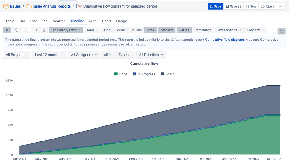

March 9, 2022
Hi @winternina
I believe you have found the solution already. However, I will answer if someone else has a similar use case and finds this post.
Measure "issues history" represents values as they are at the end of the selected period. Measure considers all changes even before the selected period to correctly accumulate the data and construct the value as it was at the end of the period.
However, sometimes it makes sense to start from point zero, especially for longer or maintenance projects.
We have prepared a dashboard for Kanban projects: https://eazybi.com/accounts/1000/dashboards/41359-kanban.
The dashboard contains a Cumulative Flow diagram for the selected period without showing the baggage of resolved issues in the past: https://eazybi.com/accounts/1000/cubes/Issues/reports/621572-cumulative-flow-diagram-for-selected-period.
Best,
Zane / support@eazyBI.com
