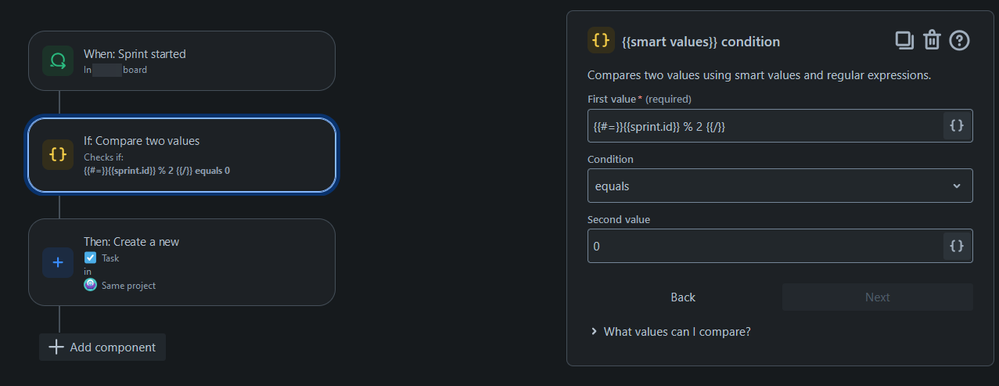

My automation should create a taks every 2 sprints for some one to do something.
The only way I could think of making this work was to check sprintID using some algebric check on even/odd sprintID
i've set it to have
Trigger upon sprint start
Check smart condition value
{{#=}} {sprint.id}} % 2 {{/}} equals 0
then create task into next sprint
is this approach any good?
Trudy P Claspill
December 9, 2024
Hello @Andrea Enis Tedeschi
No, that is not a good approach.
Sprint IDs are assigned at a global level. Sprints may be getting created in Scrum boards elsewhere in your Jira system and each of those consume sprint IDs sequentially. Within a given board you don't get sequential sprint IDs specific to that board.
An alternate approach would be to put a keyword into the Sprint name to indicate whether or not it is the sprint that needs the task or does not need the task.
