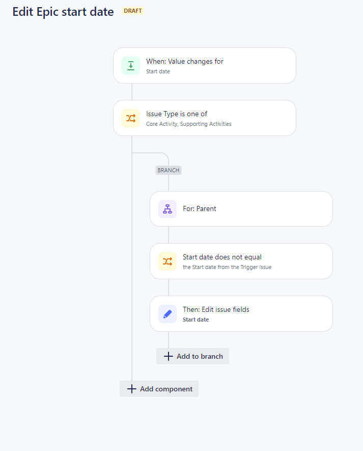

So far all I have working is this which is for to add the children of an epics start date to the epic.
It fails every time when I change the "start date does not equal" to "start date is before". So I am now stuck with this part.

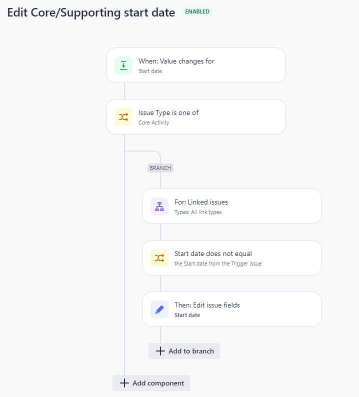

The first part of it is the same just with linked issues like below:

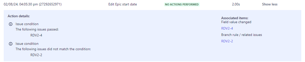

Anita Pallas
February 7, 2024

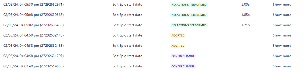

@Trudy P Claspill maybe I used the wrong word there, it doesn't fail it just doesn't perform any actionsScreenshot 2024-02-08 162331.pngScreenshot 2024-02-08 162408.png

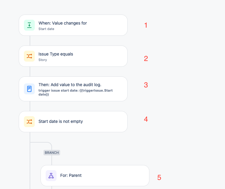

1. Trigger the rule on a change of the Start date field
2. Check the type of the issue that triggered the rule
3. This is a debugging step to print the Start date of the trigger issue into the rule execution audit log.
4. Confirm that there is a value in the Start date field. I assume you don't want to update the parent with a blank Start date.

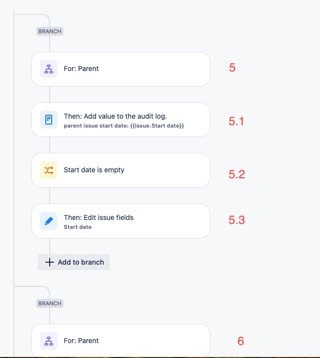

5. Create a For Each Related Issue branch and select Parent. (If there is no parent issue the rule will not execute the branch.)
5.1. Another debugging step, this time to print the Start date of the parent issue into the log.
5.2. Check if the Start date of the parent issue is empty. If it is, then any date is "earlier" than empty and you'll want to update the parent issue.
5.3. Use an Edit Issue action to update the parent issue Start date field.

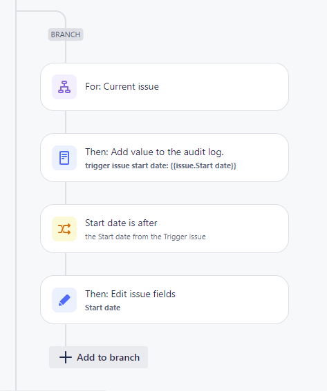

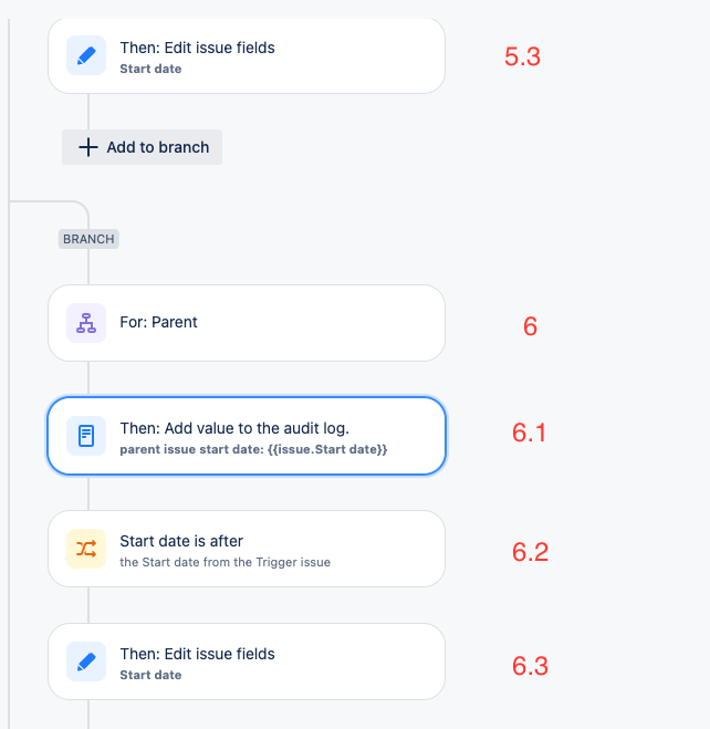

6. This is another branch, very similar to the first. The difference is that in this case the parent issue already has a value in its Start date field. So in 6.2 you check if the trigger issue Start date is earlier than the parent issue Start date.

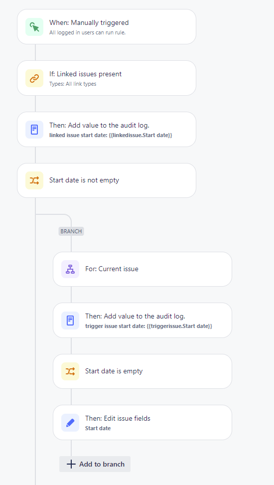

Essentially, we need to do the same as above but where you have story it should be the linked issues and where parent is it would be the story. Are you able to assist with this one as well?Screenshot 2024-02-09 164332.pngScreenshot 2024-02-09 164347.png
Trudy P Claspill
February 9, 2024
For simplicity I'm going to keep saying "Story" to refer to the type of issue where you want to update the dates.
You currently have a manual trigger on the rule. Is that what you expect to use going forward? Or do you expect the update to be triggered by some event?
The rule based on using a manual trigger from the Story you want to update would be significantly different from a rule that is triggered by the changing of a date in the linked issue, cause the update to the Story.
Also, do you want to evaluate the dates on all issues linked to the Story, or do you want to evaluate only the linked issues that use a specific link type, or the linked issues that are themselves of a specific issue type?

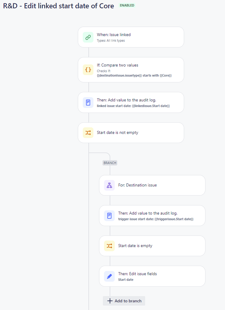

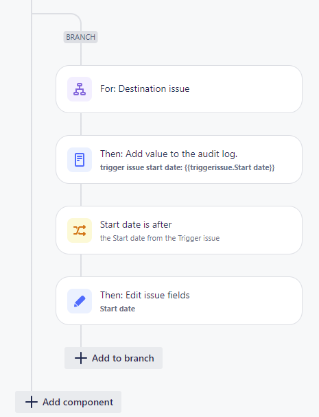

Anita Pallas
February 18, 2024
All good, I got this working in a roundabout way
