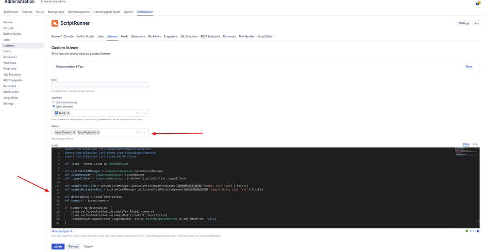

Below is a screenshot of the Listener Configuration:-

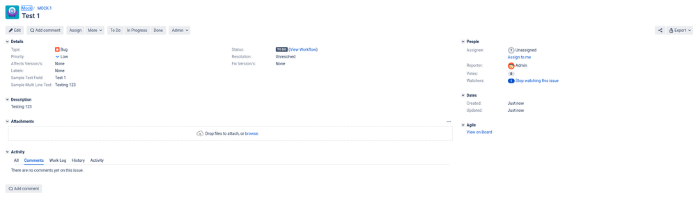

1. First, when creating a new issue, only the values for the Summary and Description fields are entered.
2. Once the issue has been created, as expected, the values from the Summary and Description fields are copied to the Sample Text Field and Sample Multi Line Text field accordingly, as shown in the screenshot below:-

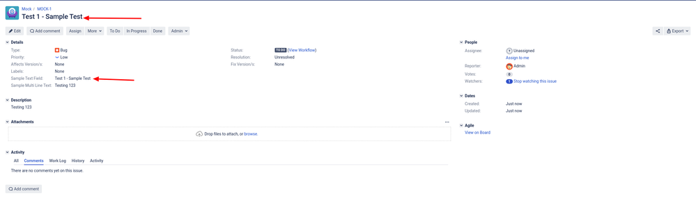

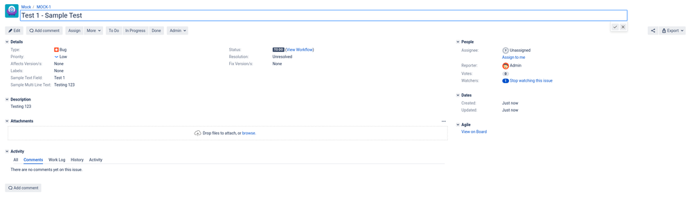

3. If the Summary field is updated, the Sample Text Field is updated accordingly, as shown in the screenshots below:-

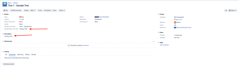

4. Similarly, if the Description field is updated, the Sample Multi Line Text field is updated accordingly, as shown below:-

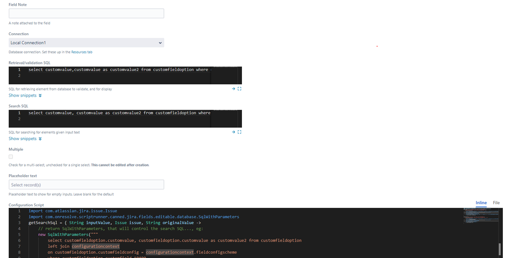

Find the configuration script below:
import com.atlassian.jira.issue.Issue
import com.onresolve.scriptrunner.canned.jira.fields.editable.database.SqlWithParametes
getSearchSql = { String inputValue, Issue issue, String originalValue ->
    // return SqlWithParameters, that will control the search SQL..., eg:
    new SqlWithParameters("""
        select customfieldoption.customvalue, customfieldoption.customvalue as customvalue2 from customfieldoption
        left join configurationcontext
        on customfieldoption.customfieldconfig = configurationcontext.fieldconfigscheme
        where customfieldoption.customfield=10400
        and configurationcontext.project=?
        and lower(customfieldoption.customvalue) like  '%' || lower(?) || '%'   and  customfieldoption.disabled = 'N' order by customfieldoption.customvalue asc
    """, [issue.projectId, inputValue])
getValidationSql = { String id, Issue issue, String originalValue ->
    // return SqlWithParameters, that will control the validation SQL..., eg:
        and customfieldoption.customvalue = ?
    """, [issue.projectId, id])

It's not the same for the Database Picker.
You can use the Behaviour to update the field based on the option selected from the DB Picker. Still, you will need to do some filtration, i.e. pull the value displayed in the DB Picker, query it via SQL and put the result in the destination field.
I suggest you take a look at this Adaptavist Library example for more information.
