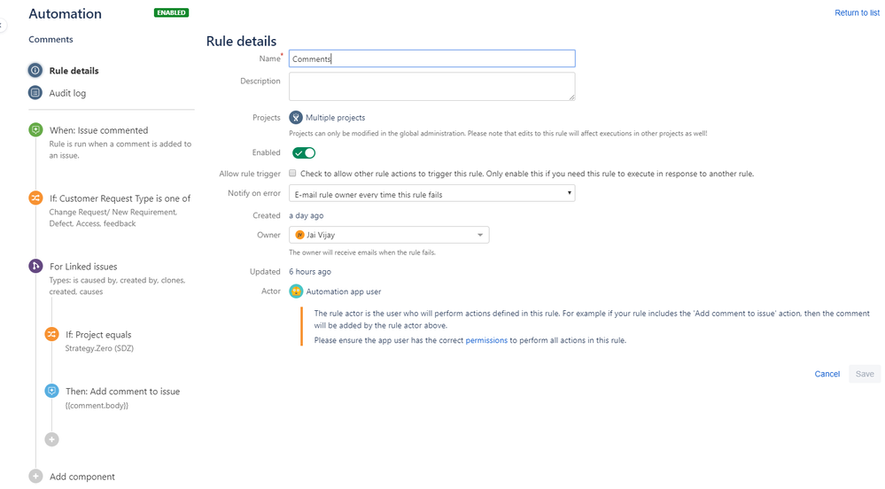

I think I made a confusion here. Let me try to explain it again. Consider we have Project A and project B (A is Parent and B is the linked one. ). In Project, I am making an update as "Hi Client, Please help me with an update" in Project A which is getting copied to Project B, If Client replies me Hi Jai, Please find the below update in the project A, that is not getting updated, and it is happening randomly where are some are getting updated and some or not, especially when the update has a screenshot. I know this is weird, but do we have any time frame that the rule takes to execute or it happens instantly once the trigger happens.
Fran Garcia
October 4, 2019
share a screenshot of your automation rule so we can see exactly how you did it.
Also would be interesting knowing the type of link you have between the issues.
Jai Vijay
October 4, 2019
Hi @Fran Garcia
Fran Garcia
October 4, 2019
The problem is in
If project equals SDZ...
It makes things work only in one direction when you make the comment in the other project.
A simple solution could be adding the other  project right in that if statement
