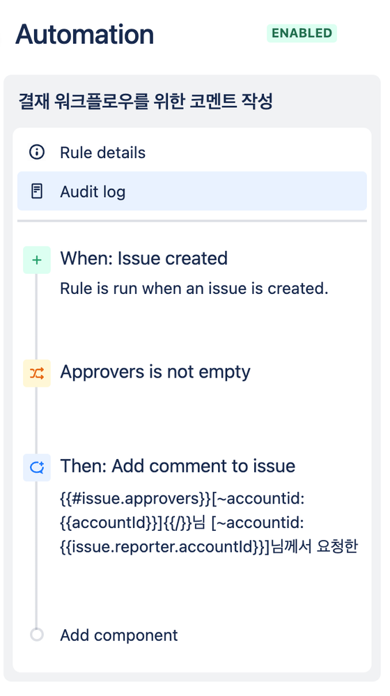

This is the rule detail

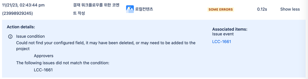

This is the error case.

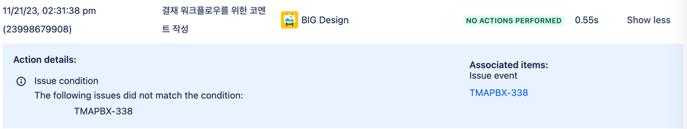

This is the NO ACTION PERFORMED case.
Both LCC and TMAPBX doesn't have Approvers field
So I wonder why they have different error message.
Trudy P Claspill
November 21, 2023
Are both projects Company Managed projects? If so check if the field is present in the Field Configurations used by the issue types being created.
While both projects may not have the field on the screens, the one resulting in No Actions Performed may have the field in its Field Configuration. That would enable the rule to resolve the field reference. If the field is not in the Field Configuration for the project and issue where you get the error, that could be the reason for the error.

Trudy P Claspill
November 22, 2023
@백재현/DevOps
Company Managed projects use Field Configurations that can be managed by a Jira Administrator and shared by multiple projects. If the field is listed in the Field Configuration then the Automation Rule can resolve the field reference.
Team Managed projects do not use Field Configurations. Team Managed project know only about the fields that are available on the screen for that specific project. If the Approvers field is not present in the Team Managed project's screen, then you will get that error.

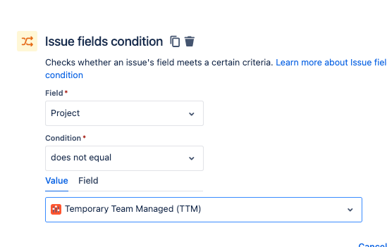

Another option is to add a Condition immediately after the Trigger. In that Condition check that the Project field of the triggering issue is not equal to the Team Managed project. The rest of the rule would then execute only for a issues in projects other than that one Team Managed project.

Trudy P Claspill
November 23, 2023
Hello @백재현/DevOps
My suggestion was not to use a Condition to check if the trigger issue project was Team Managed or Company Managed.
My suggestion was to use a Condition to check if the Project field of the trigger issue indicates it is from the specific Team Managed project that you want to exclude:
