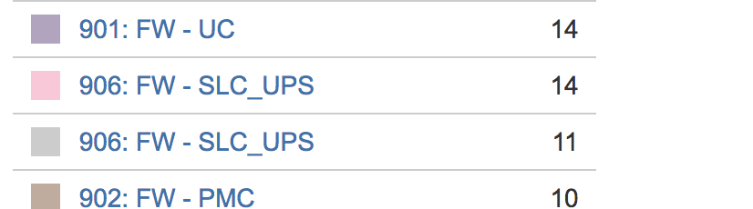

Using pie chart gadget to display by component.  I am seeing some components show up twice.
There are 197 issues in the filter, but when adding up by component it shows 220 so there are some being shown twice.
I noticed that if an issue has more than one component,  it seems to show up twice in the results.
Is there any way to see each component only 1 time?
All issues are from the same project btw.

OK figured it out. I swore up and down that there were issues from only one project. But the filter contained 4 filters. Each of those 4 filters contained other filters .. by the time I dug into the layers of filters, there was one filter that pulled in issues from another project that also contained the same component names.

The filter is actually a filter of filters.. i'm also suspecting that may have something to do with it.   It looks like this:
filter = "Unresolved FW defects S>=7" OR filter = "Unresolved FW defects SOD>=125" OR filter = "Unresolved blocking FW defects" OR filter = "Unresolved FW defects no SOD"
I did try the issue statistics filter / by component / including resolved and I see the same problem  with components showing up twice.   It's funny it's like 2 sets of components  -- they are not even sorted so they show up next to each other.
I'm going to dig into the individual filters to see what I can come up with, and also I am going to try and replicate this in a test project with less issues and components.

The only thing is that if I click the first 906 it's just issues with component 906. The second "bucket" of 906 issues are issues with 906 and one other component.

example of results - you can see that 906 shows up twice.   one group has issues solely with 906 as the component, the other has 906 + another component selected.
