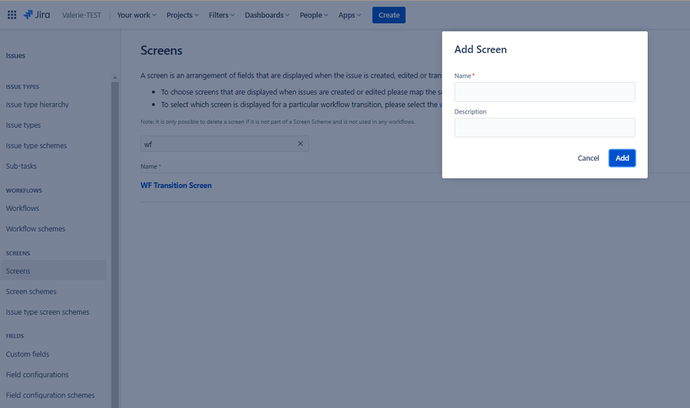

Under the menu for System settings, Issues, choose the menu for Screens and create a screen by clicking the blue, 'Add' button in the top right corner.
Here, I just called the screen, "WF Transition Screen" but you can give it whatever name you want, and then add the field you want the user to be prompted to fill in. In my case, I used the Labels field.

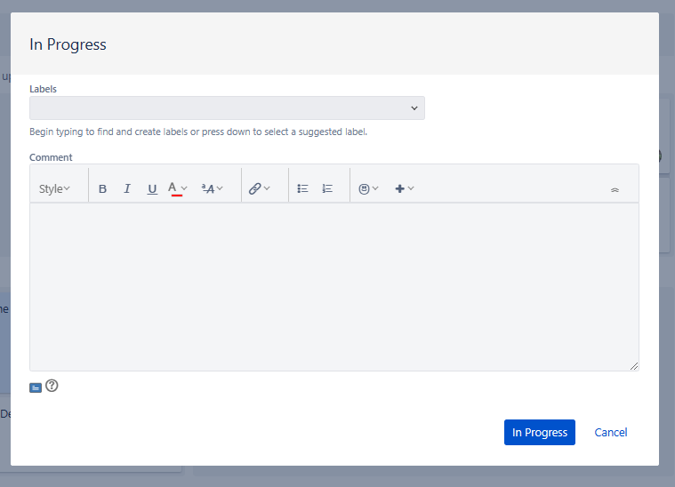

Next, you need to modify the workflow. Staying in the system settings, Issues, this time go to workflows, find the workflow you want to edit and then click on the arrow next to the transition, like this, then in the window that pops up, click on the 'Edit' button to add the screen you want to appear on the transition. Publish your workflow.
Then, when you try the transition, this screen should pop up, where you can edit the field or not. Using something like a condition or a validator, it is harder to say that filling in the field is optional, as these are generally used where some input is missing or you have to have a defined level of permission to be able to transition the issue.

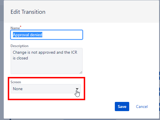

This is as you say done with workflow transitions, the option you're suppose to look at is adding a screen to the transition. Create a screen with the fields you'd like to show, then head to the workflow and change the transition screen to the screen you've created.

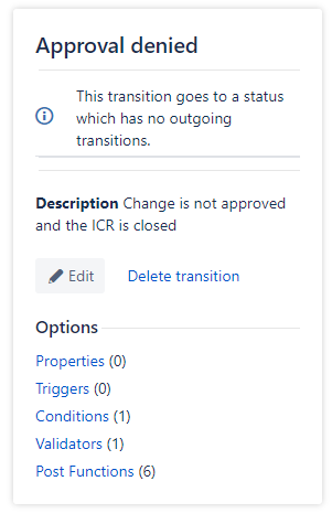

Making a field required/mandatory is done with the Options on the transition, to make it mandatory you'd add a validator.
