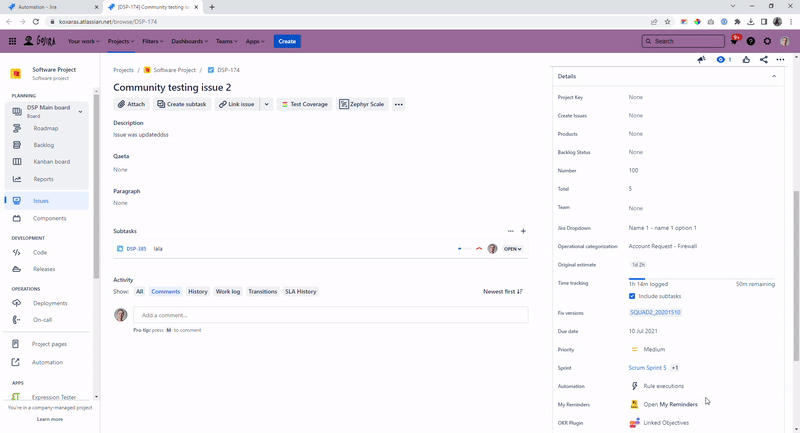

The smart value I provided works just fine. I've tested it on my instance with both your examples and it yields correct results:
