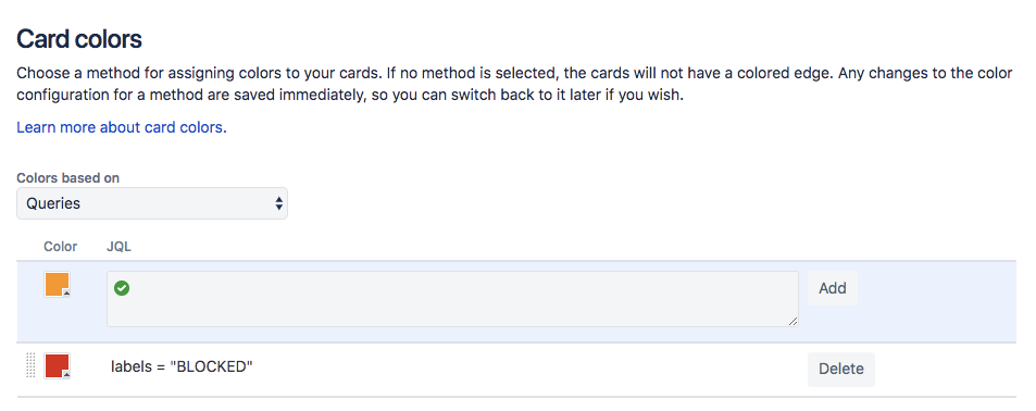

Cecil Dearborne July 31, 2018
@Jack Brickey, I want to have my cards/issues highlighted with a red color if they are blocked. I decided to use the "BLOCKED" label to keep things simple for now.
Here's a screenshot of what I did but the end result is that the cards are not showing up red. I even went to a specific card, clicked on the "BLOCKED" label which took me to a screen that showed all cards with that label, and then I copied the JQL from that screen and reused it.

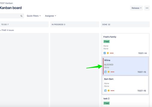

Jack Brickey
July 31, 2018
it is working for me in Cloud (see below). Question, when you begin to type BLOCKED in the JQL do you get the auto-complete box where BLOCKED shows? If so please select the label from there. If you do not see the label then chances are you are not entering it as correctly, remember case-sensitive.
