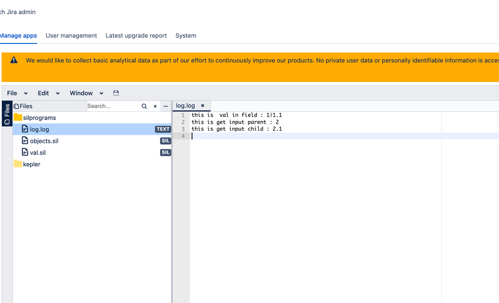

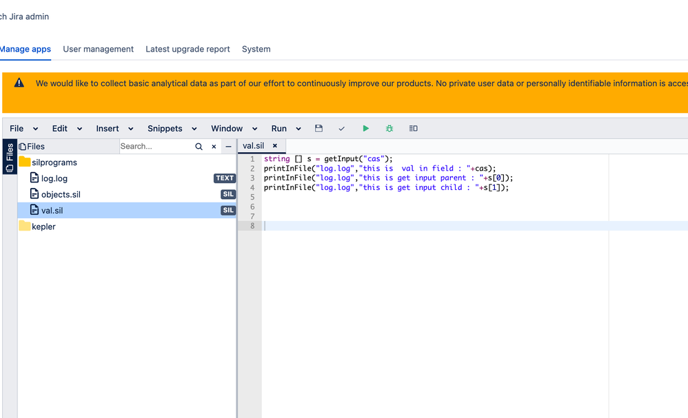

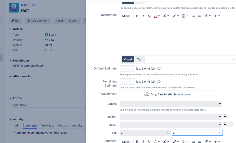

here I am sharing the screen capture showing the value that the getInput captures.
Screenshot 2024-05-10 at 7.50.57 PM.pngScreenshot 2024-05-10 at 7.51.22 PM.pngScreenshot 2024-05-10 at 7.51.35 PM.png
