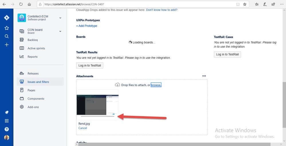

I can't upload any images or attachment on issues while creaation or after create the issue.
The progress bar keeps doing nothing no matter how much time I wait for.

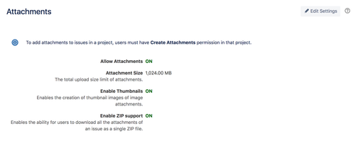

1 - Navigate to JIRA Settings > System > Attachments.
2 - Confirm that Attachments are allowed in your instance and that the file uploaded is not larger than the permitted:
