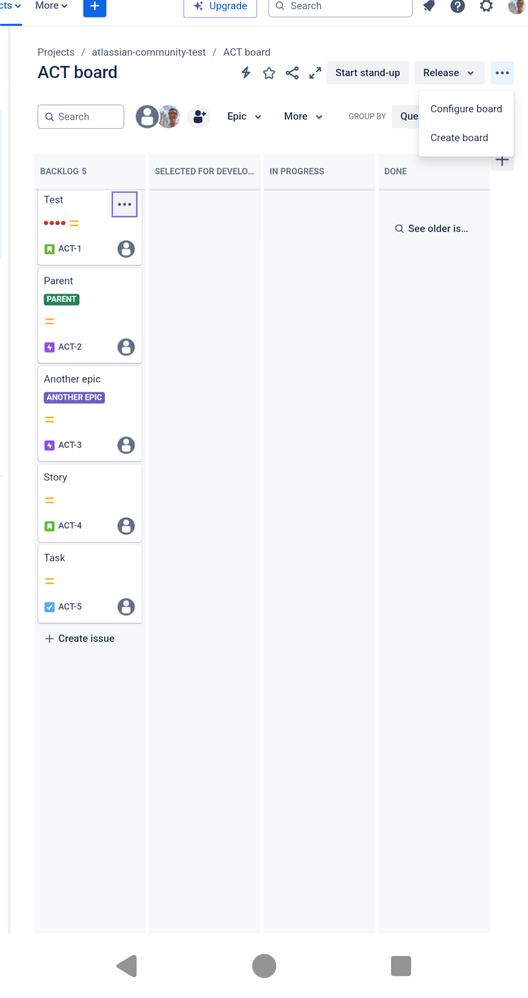

Here I have a very simple board with a few issues

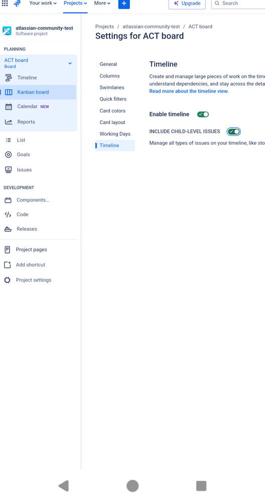

Then, when I go to "configure board", it should be possible to switch on the timeline view and to include children issues in the view or not

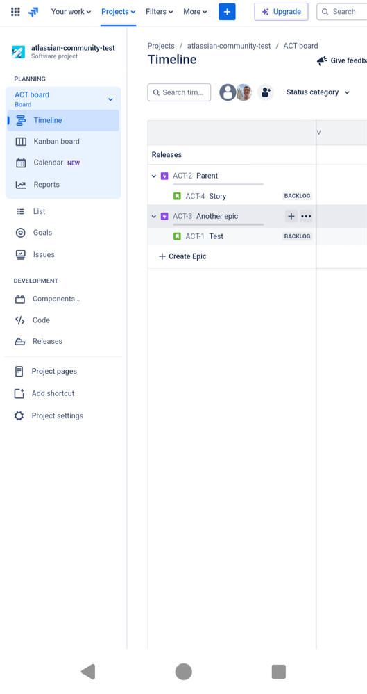

With this configuration, I can see the Epics and their linked Stories in the timeline
What is your configuration? How is it different?
