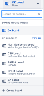

I'm not entirely sure about the best place to start, but here's how I managed to simulate what I think you are trying to achieve. Step by step (I am using the new navigation):
  • I opened a random classic jira project, as this has a classic board.
  • Expand the menu on the left from the current board name and choose create board (at the bottom of the menu).
  • Choose Create a kanban board
  • Choose Board from an existing saved filter
  • Give your board a name, select your saved filter as the issue source and select your profile as the location for the board.
  • Then click Create board.
And you should be fine.

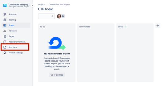

I would recommend you then copy the url of your board and paste it as a link in the left navigation bar of your next gen project:
Otherwise it will be hard to find it again.

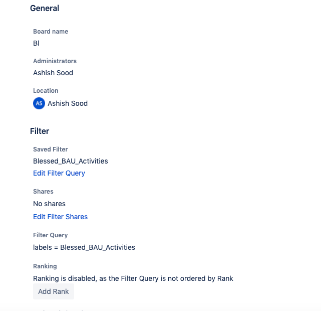

Hey, I have exactly followed your steps but I am still not able to see the jira on the board. I have also checked the general setting and the filter is set to the saved filter itself.
Ashish Sood May 12, 2020
I am not being able to see the next-gen Jira tickets on the board made in the classic type
