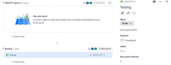

Mirek
November 21, 2018
That was exactly my point :) .. You cannot have classic Scrum/Kanban boards used with Next-Gen projects. It is all Next-Gen or nothing. Glad that it is clear for you now :)

Mirek
November 19, 2018
According to this guide - https://confluence.atlassian.com/jirasoftwarecloud/migrate-between-next-gen-and-classic-projects-957974933.html
Story points estimation: This data will be lost, however you'll be able to start using story points estimation by enabling the Estimation feature in your next-gen project.
Story points would be lost if you migrated from classic, but should be able to enable those again.
https://confluence.atlassian.com/jirasoftwarecloud/estimation-959303560.html
However this would be a complete different field as note for admins describe
When you navigate to the issue type configuration screen, you might notice that there will now be two Story point estimate fields when you do this. This is because one is for classic Scrum/Kanban projects, and the other is for next-gen Scrum/Kanban projects.
On you screenshot I see that you would like to use standard Scrum/Kanban boards so that might not work. You need to use Next-Gen boards to see the estimate on your Backlog as below..
Deleted user
May 24, 2019
You need to enable Estimation under Project Settings > Features. Then double check on Issue Types > Issue that the Story Point Estimate by Jira is added to list of fields.

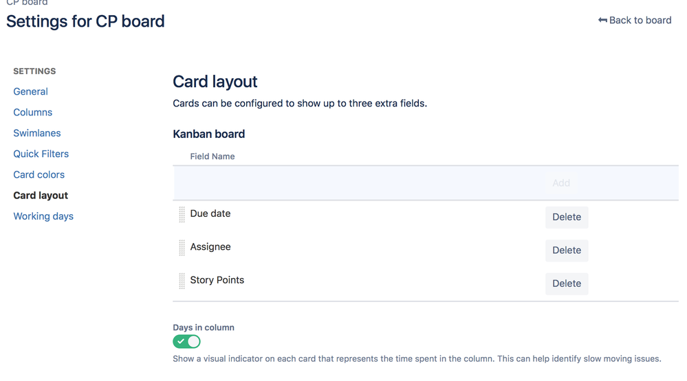

Tinker Fadoua
November 18, 2018
@Mehmet CeditIf you are the board admin, you have to click on
board settings -> card layout then select the fields you want to see in your tickets on the board:
Like Sheikha Thakkar likes this
Mehmet Cedit
November 19, 2018
Thank you, I have already done this, but still the values are not showing
http://prntscr.com/lk4jqt
